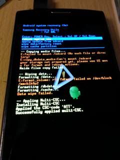

I took a couple of pictures on the recovery screen to show what it is saying. It almost seems like the internal sdcard is shot.
before factory reset/wipe data:
After wipe:

After trying this it started boot looping then I tried wiping data and doing it again and got back to boot looping.
After wipe:
Seems indeed like the sd is dead.
Do you have a external sd that you could use to boot on? I'm not sure if would work but worth giving a try.

The internal sd is within your motherboard so if you can swap the MB from one to another, it should work!
