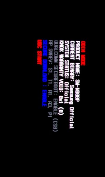

Thanks to a few memebers here for posting back. I went ahead and used CF AUTO ROOT to root the newest firmware. Below is screen shot in Odin mode.
Some issues to share;
First, if i want to use my home wifi, I have to reboot my phone for it to work. Can anyone confirm this?
Second, thanks to the galaxy tool, I now have hotspot again.
My issue here, it only allows one device to connect at a time. For the use of another device, I have to turn off one.
Anyone having these issues?

Check out my post 4.4.4 ( Download Mode ) below, that I made right after I upgraded to 4.4.4, now check out the post above. Is that number (4) a flash counter ?
I have since gone back to 4.4.2, there's to many problems with 4.4.4. So is anyone rooted with 4.4.4 that can check this out ?
Does it reset if you unroot the device and go back to official stock ?

I only flashed/rooted this phone yesterday using odin3 v3.07 and noticed you can't uncheck F.reset time. Now, my binary and sytem says custom.
See below screen shot.
I am not running a custom recovery.
If i wanted to go back to nc5, can I use odin to do that?
Thanks.

Odin can put you back to nc5.
And if you can't uncheck it on the menu do it in Odin3.ini
[APOption]
FResetTime=0
