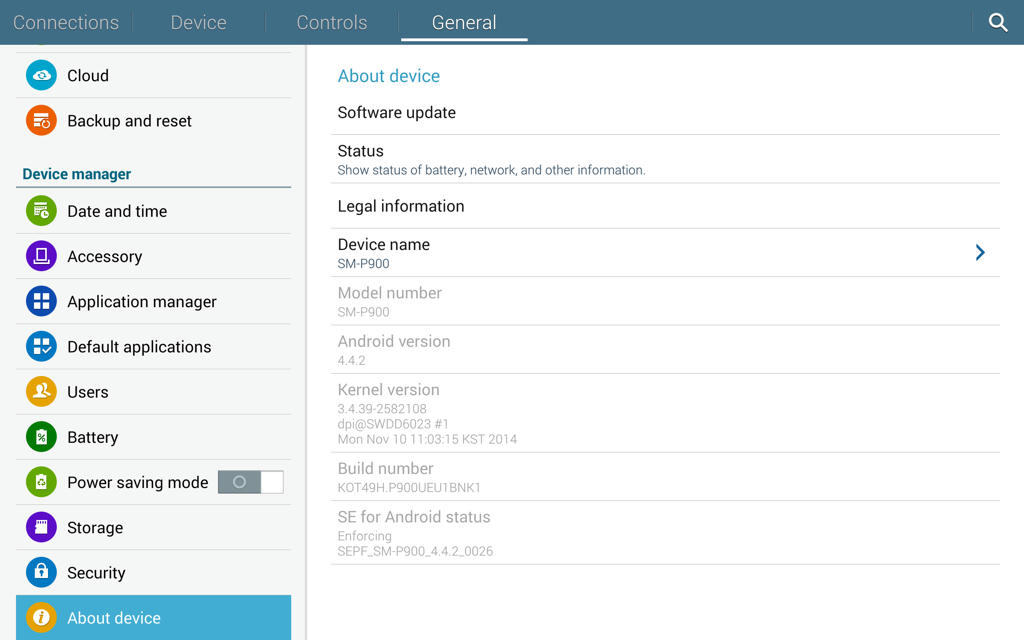

This is my current Lollipop OI1
I downgrade it to NK1, this process only takes 5 minutes
I did it only for demonstration but personally I think Lollipop has a better graphic interface, then I go back to Lollipop .
I can go back and forth from Kitkat to Lollipop with ease as long as right bootloader is loaded.
