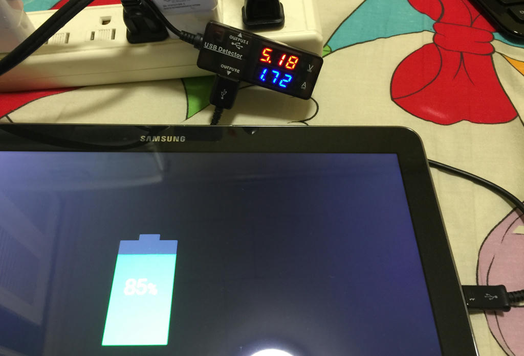

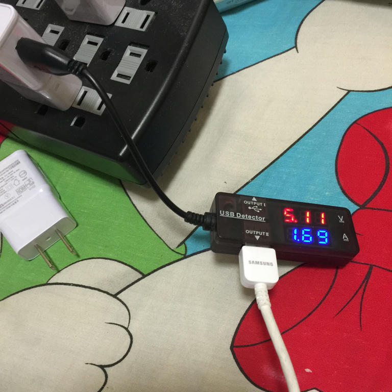

It doesn't matter if you're using 5 volts/2 Amps or 5.3 volts/ 2 Amps adapter as the charging current is almost the same: around 1.7 Amps.
However, incorrect USB charging cable will draw less current although it's USB 3 cable, so the important is buying the USB 3 cable designed for this model. It usually is larger in diameter so it can draw more current. If you get around 1 Amps, your USB cable is the wrong one unless the tablet is almost fully charged. Under 90% battery, the charging current should be around 1.7 Amps.
Here is the 5.3 volts adapter
Then I'm using 5 Volts/2 Amps adapter, the charging current is almost the same
However, the charging current is less when using the wrong USB 3 cable
So the key is buying the USB cable specifically designed for the Note Pro 12.2 inches. In above picture, the USB 3 cable is smaller in cable size which is for phone, draws only 1 Amp current. You can use the micro USB too, as charging is the same as USB 3 cable which has only faster speed for data transfer but this micro USB 2 cable must have a rate at 2 Amps, micro USB for phone only draws 1 Amp at max.

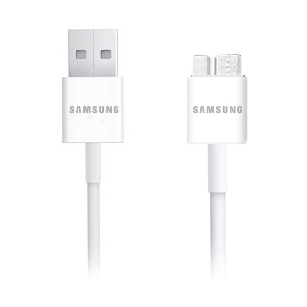

Any idea where to find an authentic USB 3.0 cable? I did buy this tablet used and it came with a usb 3.0 cable that *looks* legit in that it is noticeably heavier duty than a standard microusb cable and resembles both of the cables that you show in your pictures, you'll agree there is a very slight difference in appearance between the authentic and the non authentic USB 3.0 cable. One might only be able to tell the difference between them if they were side by side.
I have a regular microusb cable that came with my Note 5. The adaptive fast charger does output 2A. Is it a safe/accurate assumption to think that this microusb cable would be able to support 2A for the Note 12.2?
If not, can you link me to where I could purchase a cable that meets the charging requirements?
The micro USB is working fine as the USB 3 cable has the same rate of 2 Amps, it's only faster by data transfer because it's USB 3. If you're looking closely, the portion for charging of USB 3 is the same as micro USB, the other one for data. USB 3 cable is the same as micro USB for charging but its data transfer rate is 10 times faster.
Micro USB cable must be 2 Amps cable, it's usually larger than the 1 Amp cable by size.
However, if you want USB 3 cable, try this one
https://www.amazon.com/Samsung-Sync...8&keywords=usb+cable+for+galaxy+note+pro+12.2
