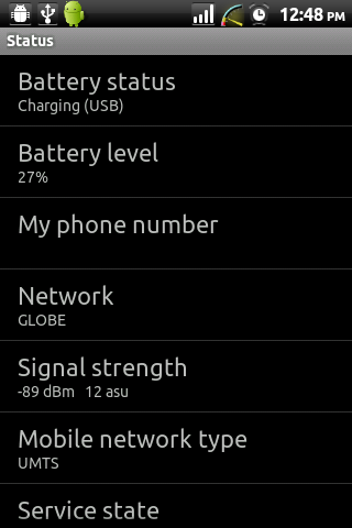

I added the raido a min ago.
Before 81dbm / 16asu
After 67dbm / 23 asu
The weather cleared up, but wifi is unfortunately the same:p lol

I upgraded from stock HTC Legend radio to this one and I now have signal at my desk at work. Before it was like the black hole of Calcutta.
Vodafone Australia, Froyo Stock (well, as stock as possible)

Slighty better for me:
Radio v7.05
Desktop-> -93 dBm
In my bed-> -89 dBm
Living room-> -89 dBm
Bathroom-> -101 dBm
Terrace-> -75 dBm
Radio v7.13
Desktop-> -93 dBm
In my bed-> -83 dBm
Living room-> -85 dBm
Bathroom-> -97 dBm
Terrace-> -71 dBm
