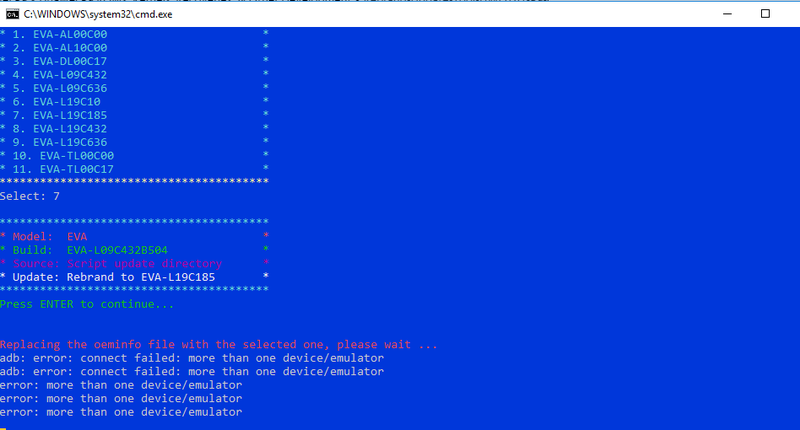

curtricias
Oct 9, 2012
213
41
Kortessem
I am sorry, but every test I do is working... This might be, because I am on Custom Rom and not on Stock - I dont know. Maybe I do something wrong, but I cannnot find any missing options...
Everytime i wan't to run te script i'm facing this problem. Anyone an idea?
Edit:
Hisuite was running in the background..... Stupid me. But so far so good. After changing oeminfo.... the same thing happend :roll:
Edit:
To you have perhaps another adb terminal open in the background?
If HiSuite is enabled on your phone you must close it too (in settings)
Tecalote
Aug 6, 2015
4,077
3,104
253
Leipzig
No. Uninstalled hisuite just tot make sure. Rebooted and they the changelog of OEM worked. But right afterparty that, as you van der, the sale error came.
Even if you have uninstalled HiSuite, you have the setting in your phone:
Settings /Advanced settings/security / disable HiSuite HDB.
Reboot phone and reboot PC.
Have you the hwota folder on c (C:\HWOTA7) and not changed anything in the folder structure of the subfolders?
Did you rename two of the FullOTA-MF zip files?
Have you checked the downloaded HWOTA 7 zip file with md5 check?
The error is not from the Tool. You must find out what is conflicting with the Tool.
It can also be Anti-virus program on PC, with sandbox or anything else
Edit:
You can have more than one device/emulator present and connect
just run
adb devices
adb - s device : port shell
Reactions: Tecalote

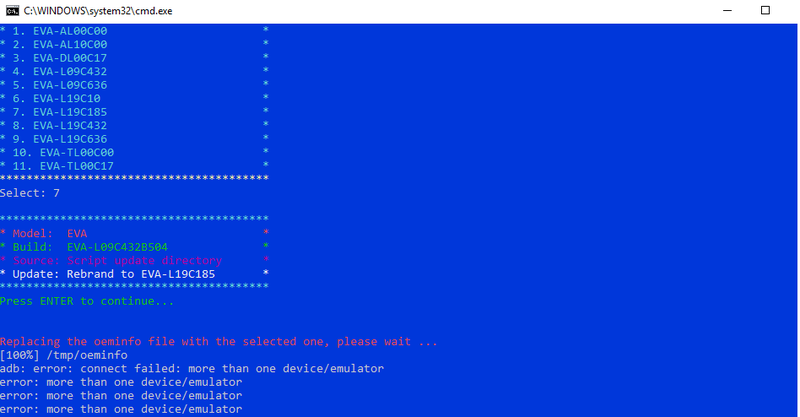

curtricias
Oct 9, 2012
213
41
Kortessem
just run
adb devices
Hi.
The code gives an error.
---------- Post added at 01:48 PM ---------- Previous post was at 01:46 PM ----------
I checked everything you wrote but the problem remains.
Could my systemwide adb on win10 maybe be the problem?
Can I do the steps manually?
Edit: i also have ubuntu on my pc. And i wanted to try to run te script from there but then i got this error :D
Tecalote
Aug 6, 2015
4,077
3,104
253
Leipzig
Hi.
It's made for working with windows.
If you have adb systemwide installed, just uninstall this App from Control Panel.
The Tool has everything what's needed. This should work.
Reactions: curtricias
