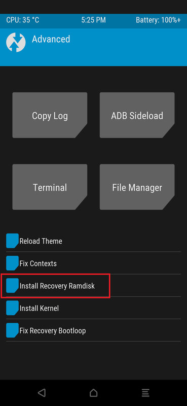

Other Install guide:
1. Install fastboot tools from google's sdk on your PC
2. Enter fastboot mode
3. Unlock your bootloader
4. Run "fastboot boot recoveryimgfilename.img" in command line
5. Copy the recoveryimgfilename.img in the phone memory
6. Go in advanced menu
7. Click on "Install Recovery Ramdisk"
8. Choose the recoveryimgfilename.img
9. Swipe to install
