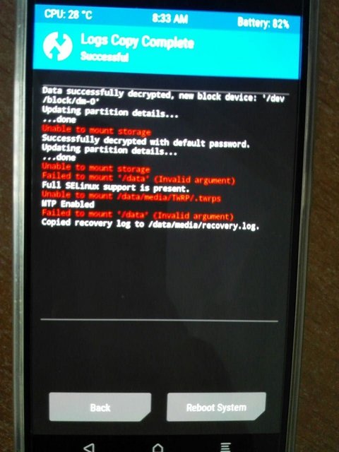

Here is my log, could you check it please?
h**ps://www.filedropper.com/recovery_4
I had to slightly modify the link to be able to insert it.
Thanks
@Captain_Throwback
I forgot, when he created the log the usual errors appeared even if he says created successfully ..

Please don't post pictures of your phone screen. The recovery log is sufficient. If you feel like you really have to give me a screenshot, please use Power+Volume Down to capture a proper screenshot.
As I told you in the other thread, to use the "Copy Log" feature, you need to switch the storage to your SD card first, since your "regular" storage isn't working properly.
Please try the TWRP linked below and let me know if you still see errors. If you do, please attach another recovery log, and also provide the output of
adb logcat > logcat.txt
https://drive.google.com/file/d/1VcYhdSIuX-8OazWcpP3JVXgpYezHo0OY/view?usp=sharing
Thanks.
P.S. Please provide recovery log even if it's working, actually.
P.P.S. Also, there's no need to mention me, as you're posting in my thread so I will be notified.

But after looking at your log, it seems that you need to Format Data in TWRP. Wipe -> Format Data -> type "yes". Then reboot into Android and back to TWRP. Please let me know if that resolves your issue.

I made a format data and I solved the errors .. now he doesn't make them + ... and this is already a very important first step .. I was sure that with you I would have solved it since you are the leader of the experts.
The weird thing I am wondering is when flashing the RUU doesn't it automatically do a format data? because the RUU I flashed it I don't know how many times and this problem was always present.
I'll put here a log made now after making the format data
http://www.filedropper.com/recovery_6
Still need the logcat file?
Now the famous screen that appeared to me every time whether to allow changes to the file system or keep read-only has also disappeared, and every time I selected "keep read-only" now it is not appearing +.
