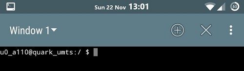

* This must work on all devices model quark (XT1250 and XT1254) or quark_umts (XT1225) * custom ROM may display only quark
To know you device model just open the app Terminal Emulator for Android and see the quark after the @ like below.
