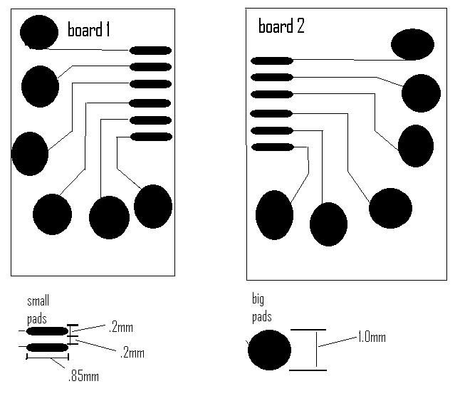

id like to atempt to make a connector to help you guys out. i have a couple ideas and the tools for precision work but dont feel like disassembling my phone for the proto-type proceedure. if you get a couple phones maybe i can help out.
Dani897
Aug 16, 2010
3,613
670
Danny, the connectors are available online, however if you'd like to help, we could use two circuit board like this:
http://i1098.photobucket.com/albums/g374/adamoutler/solder_board.jpg
If you make these, please let me know. this would allow plug-in access.
well im waiting to here from my friend who was a tool and die maker still. he is out of town. would really like to use his more specialized tools, high spindle speeds are needed for the tiny tooling needed and a jewlers drill press would be better than what i have. i could do something a little makeshift with a dremel but would like to do it a little less sloppy. also curious why it should be 2 pieces? just trying to figure out what you are seeing...

Hmmmmmm... interesting thread. I shall subscribe. Might I request some photos and a little friendly info on your project to be posted in this thread? :)
YouTube "vibrant jtag" and the first video is of me doing this on a Vibrant/i9000. The project is the same but much harder on Captivate. Although it's no cakewalk on anything with how small jtag points are (.1-.2mm in size)...

Maybe you'll get more to bite with all the mix ups of bootloaders between 2.3.x and 2.2. Seen at least 5 ppl between various forums say "flashed back to 2.2 from 2.3 and bricked :("
Saw both the the Jtag vids from your site, hope you can get your hands on a nice two piece thing like you used for the HTC HD2.

I would love a JTAG adapter but currently none is available in the whole world for this phone. Member AdamOutler has been slowly fabbing one up for other purposes that may benefit me in the JTAG quest. But there is also a chance my skill will develop first and allow me to directly solder to the pads which I have managed to already do once and I'm hoping for some repeats on the boards I have currently in transit to me! If all goes well, I can go live with this service middle of next week.
