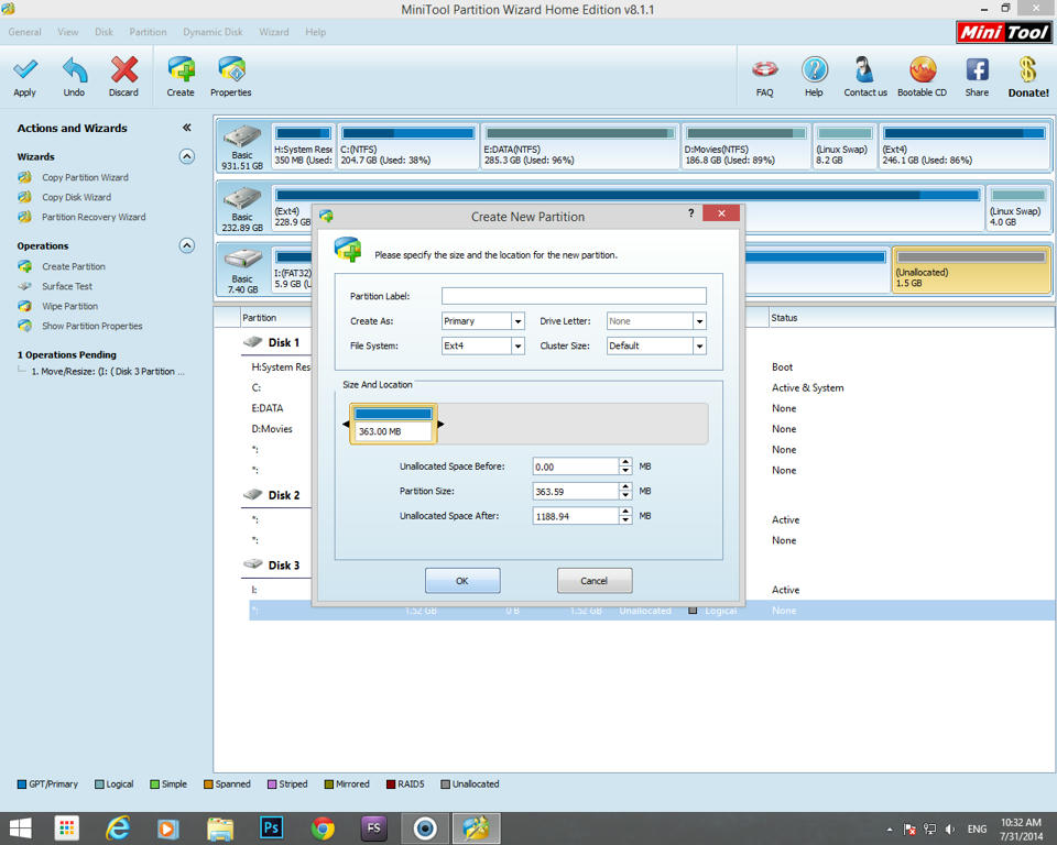

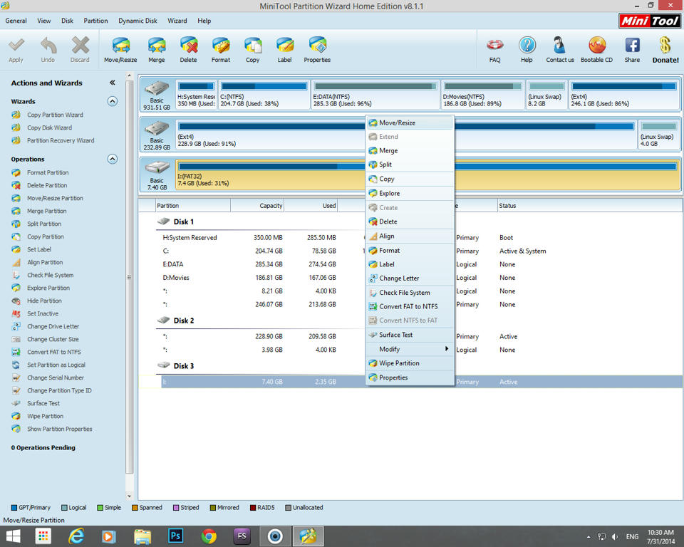

    MiniTool Partition Wizard (Windows):

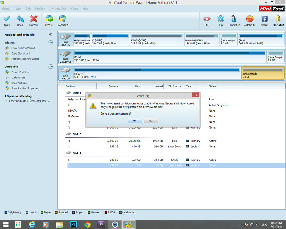

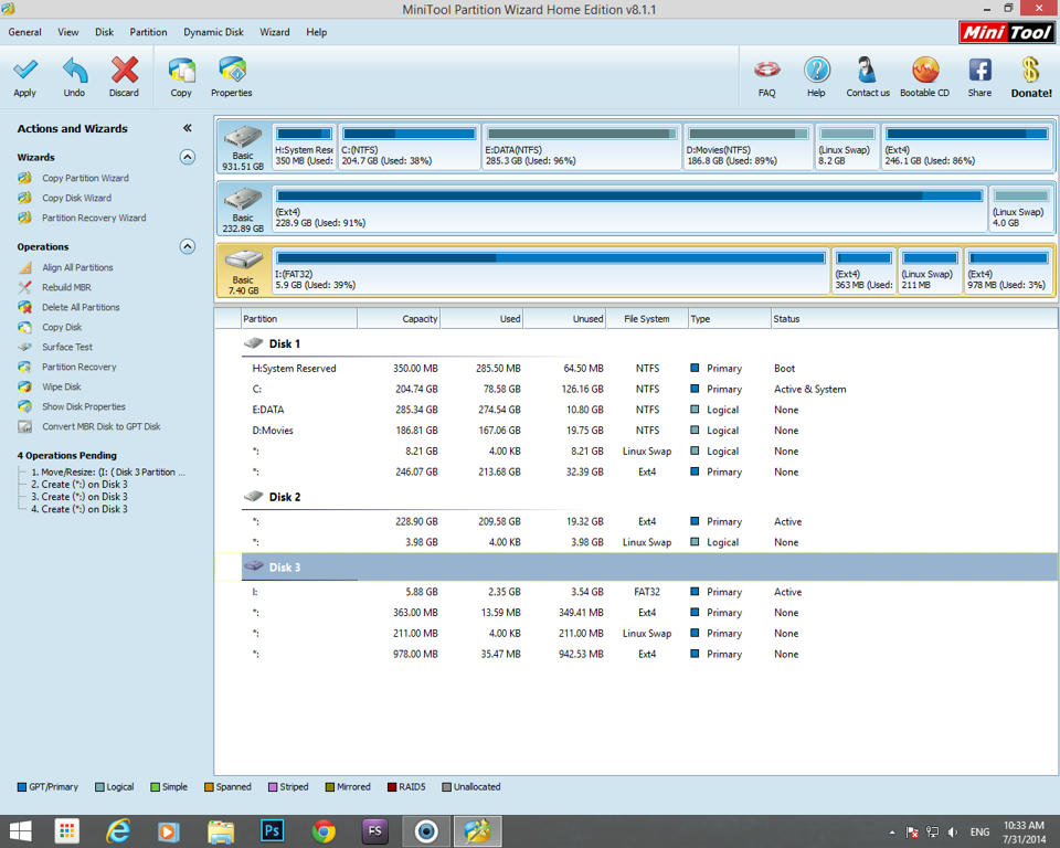

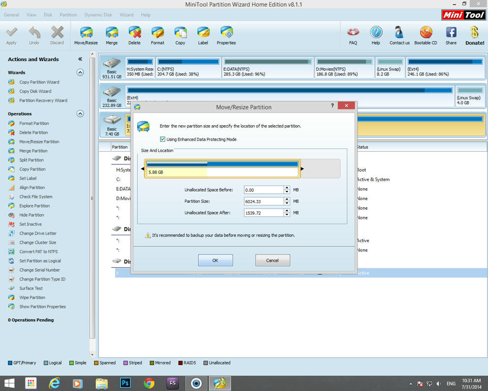

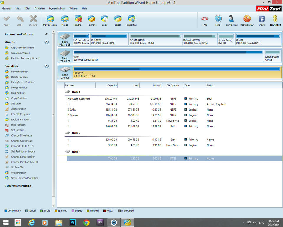

    1. You need to start with one partition formatted with fat32 (or unallocated space to create fat32 partition and skip 2 step):
    2. Right click the fat32 partition and use Move/Resize tool to shrink that partition:

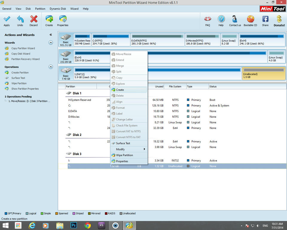

    3. Right click on unallocated space and select Create. Following this create ext4, swap and again ext4 partitions:
    4. After that you should end with this configuration (partitions sizes may differ) then hit Apply:

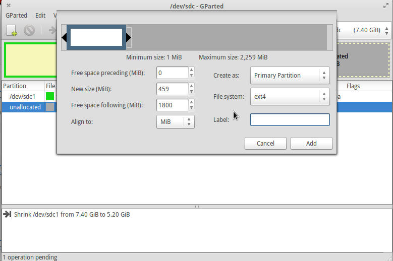

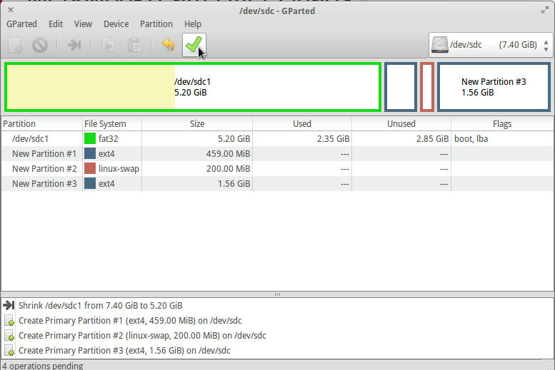

    GParted (Linux)
    2. Click the fat32 partition and resize it to shrink partition:
    3. On unallocated space create create ext4, swap and again ext4 partitions:

I tried partitioning SD card using minitool partition, installed TWRP, ROM and GAPPs.
Try to do a dalvik/cache partition but I had failed, TWRP doesn't mount data partition.
I tried more time without success.
Minitool doesn't accept / before name in the labeling and then I try using data e system (instead /data and /system).
Tri to boot mobile, but It doesn't boot (I wait 20 minutes).
Any idea?

Have no experience with Windows Mini Tool. Re-partition SDCard by using Linux (assuming you have a Linux box).
Here what I did as I posted previously.
Execute Terminal as root:
# fdisk -l will show sdcard, /dev/sdx
# fdisk /dev/sdx, follow the instruction to make partition in primary (p): vfat, ext4, swap, ext4.
formatting partitions
# mkfs.vfat /dev/sdx1 (for vfat file system)
# mkfs.ext4 /dev/sdx2 (for ext4 fs)
# mkswap /dev/sdx3 (for swap)
# mkfs.ext4 /dev/sdx4
Since Android based on Linux, making partition using Linux command is more accurate than Windows, IMHO.
Any idea?
Then partitioning you don't need to change partitions names, leave it blank. So after partitioning fat32 will have Removable Disk and other * names by default.
