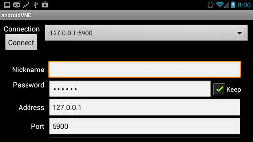

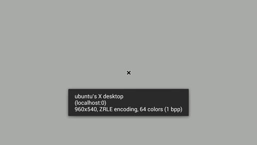

Hi there… I have Linux-on-Android working with SuperLite, though VNC Viewer did kick me out the first time, lol.
Here’s my listing of loop devices (note esp. /dev/block/loop255):
C:\Program Files\Android\android-sdk\platform-tools>adb shell
[email protected]:/ $ su
su
[email protected]:/ # cd /dev/block
cd /dev/block
[email protected]:/dev/block # ls -ld loop*
ls -ld loop*
brw------- root root 7, 0 2013-03-11 17:37 loop0
brw------- root root 7, 1 2013-03-11 17:37 loop1
brw------- root root 7, 2 2013-03-11 17:37 loop2
brw------- root root 7, 255 2013-03-11 17:50 loop255
brw------- root root 7, 3 2013-03-11 17:37 loop3
brw------- root root 7, 4 2013-03-11 17:37 loop4
brw------- root root 7, 5 2013-03-11 17:37 loop5
brw------- root root 7, 6 2013-03-11 17:37 loop6
brw------- root root 7, 7 2013-03-11 17:37 loop7
And here’s the loop device setup and Ubuntu image mount code from /data/data/com.zpwebsites.linuxonandroid/files/[auto]bootscript.sh :
# Set up loop device and mount image #
echo -n "Checking loop device... "
if [ -b /dev/block/loop255 ]; then
echo "FOUND"
else
echo "MISSING"
# Loop device not found so we create it and verify it was actually created
echo -n "Creating loop device... "
$bbox mknod /dev/block/loop255 b 7 255
echo "OK"
else
echo "FAILED"
error_exit "Unable to create loop device!"
fi
fi
$bbox losetup /dev/block/loop255 $imgfile
if [ $? -ne 0 ];then error_exit "Unable to attach image to loop device! (Image = $imgfile)"; fi
Screenshots:
I believe that to fully render the Ubuntu desktop you have to be running ICS which has the needed graphics acceleration (at the expense of increased battery drain).
Anyway, I would try again and look for this message on Terminal Emulator after launching Linux on Android with a valid Ubuntu image:
"If you see the message 'New 'X' Desktop is localhost:0' then you are ready to VNC into your ubuntu OS.."
Hope this helps:)

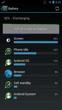

Airplane Mode and Battery Life
And what about battery life?
Is it really better than Epinter`s?
Enviado do meu MB860
I expect that since SuperLite uses epinter's boot image (and hence the same kernel), battery life would be about the same as that of epinter's CM10.
Have you tried using airplane mode during times of expected non-use? Settings > Data usage > More ... > Wireless & networks > Airplane mode (checkbox)
I did this the past two nights with great results. Here's an example with mild use at bedtime and in the morning (note airplane icon just left of battery icon):
My understanding is that in airplane mode, you can't make/receive calls or texts. But even in SuperLite's airplane mode, I am still able to turn wifi back on for internet surfing, gmail, etc. ;)

I have the same grey screen with the Ubuntu 1204 images but the 1010 & Debian images render the desktop fine with both gnome and LXDE.
I can second your findings with airplane mode. I have no signal at home and switch to airplane mode + WiFi every night with epinters CM10/10.1. makes a huge difference to battery usage over night.

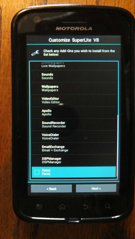

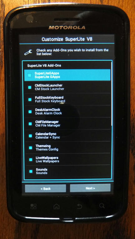

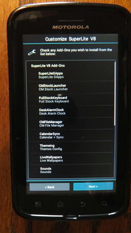

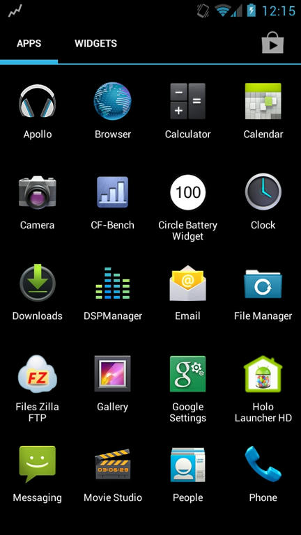

[ROM]CM10 4.1.2 SuperLite for Atrix 4g! [New! Addons Flashable Zip, 16 Mar 2013]
SuperLite-V8-Addons.zip! Seventeen apps & features rolled up into a menu-driven installer!
Link: http://www.mediafire.com/?21dn8v8p60di422
Install from recovery and reboot!
Certain apps in screenshot are not included. I forget which ones --- sorry :eek:
Enjoy!
