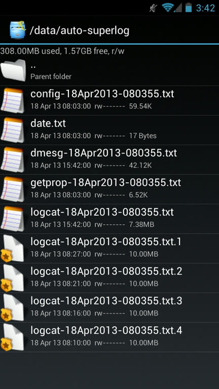

SuperLite NFC (Near Field Communication) and Battery Life
Are you experiencing unusually short battery life on SuperLite? It turns out that I retained a feature from the Galaxy S2 called NFC or “Near Field Communication”…
http://developer.android.com/guide/topics/connectivity/nfc/index.html
Near Field Communication (NFC) is a set of short-range wireless technologies, typically requiring a distance of 4cm or less to initiate a connection. NFC allows you to share small payloads of data between an NFC tag and an Android-powered device, or between two Android-powered devices.
NFC is a two-edged sword, though big plans are in the works according to this 13-page blog devoted entirely to NFC: http://www.near-field-communication.us/nfc-pro-con.html
“She took out the phone … and I thought she was going to take a picture with it. Instead, she held the thing up to the poster like she was trying to get better reception and in a second she was watching the trailer for the show…”
However because SuperLite’s NFC (/system/app/NFC.apk) is not native to Atrix, I wasn’t quite sure what to expect by keeping it on board. But I found out soon enough… After installing Boot-Time Auto-SuperLog: http://forum.xda-developers.com/showthread.php?t=2232502 my logs began to reveal a correlation between SuperLite’s NFC app and battery drain. Anytime your device tries to bind with another device, it can drain the life right out of your battery at a dizzying rate.
My log buffers were stacking up like crazy...
I reckoned something was amiss, so I opened the dmesg/logcat files and discovered that NFC was making numerous attempts to bind. And my NFC ON/OFF switch located in Settings > More… > NFC seemed inoperable as there was no feedback in the checkbox. So without logcat and/or dmesg, I could not readily tell what NFC was doing.
Even if NFC did work on Atrix, security issues come to mind: If we lose our phone, our personal information could be compromised --- though I am confident experienced Linux hackers would find other means. And I personally don’t need NFC since other (possibly more capable) wifi apps are available to fill the void (see below: Some Alternatives to NFC). So I disabled it on my Atrix using Root Explorer, which is very easy to do:

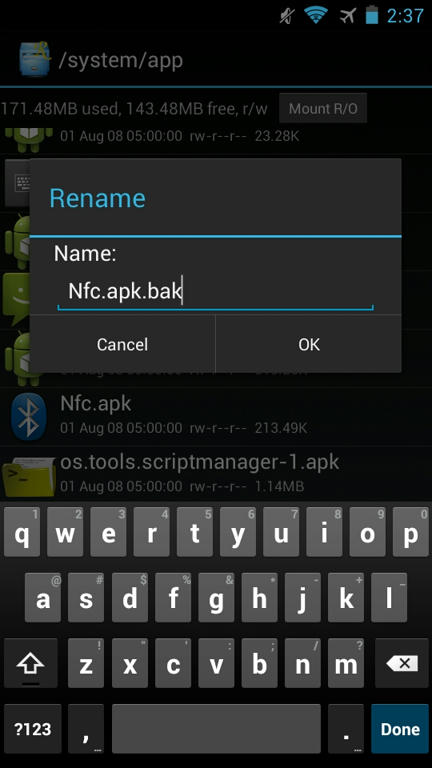

1. Navigate to /system/app and tap on "Mount R/W" near top right
2. Long press on NFC.apk and rename to NFC.apk.bak
3. Remount /system/app as read-only
And...voila, without even needing a reboot, my Atrix immediately calmed down to the point of actually getting cold :D -- even with wifi on. And Bluetooth still worked.
And battery life was much improved (with good wifi signal).​

/snip/ ... So I disabled it on my Atrix using Root Explorer, which is very easy to do:
I don't have root explorer, but command-line works well:
adb shell
mount -o remount,rw /system
mv /system/app/Nfc.apk /system/app/Nfc.apk.bak
mount -o remount,ro /system
Reactions: sendust7
