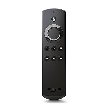

I have installed the rom fine but can not get remote to pair. I can see it in the searching for accessories screen then it goes to a settings screen. Then I can not do anything. I have tried 3 different remotes. Maybe I'm missing something but I think I'm following the instructions fine. I wait for the searching for accessories screen then hold the home key for 15-20 seconds, the remote shows up then after about 10 seconds it goes to settings screen and I can't do anything. How can I connect through ADB? Thank you for any help.
Hi. Are you using sloane's remote?
It shouldn't show up at the first screen... It should show up at that Settings Screen (Wi-Fi Direct screen).
Regards.

To be honest I'm not sure if it is the original remote. Is the original remote the little one? I'm using model-PE59CV
