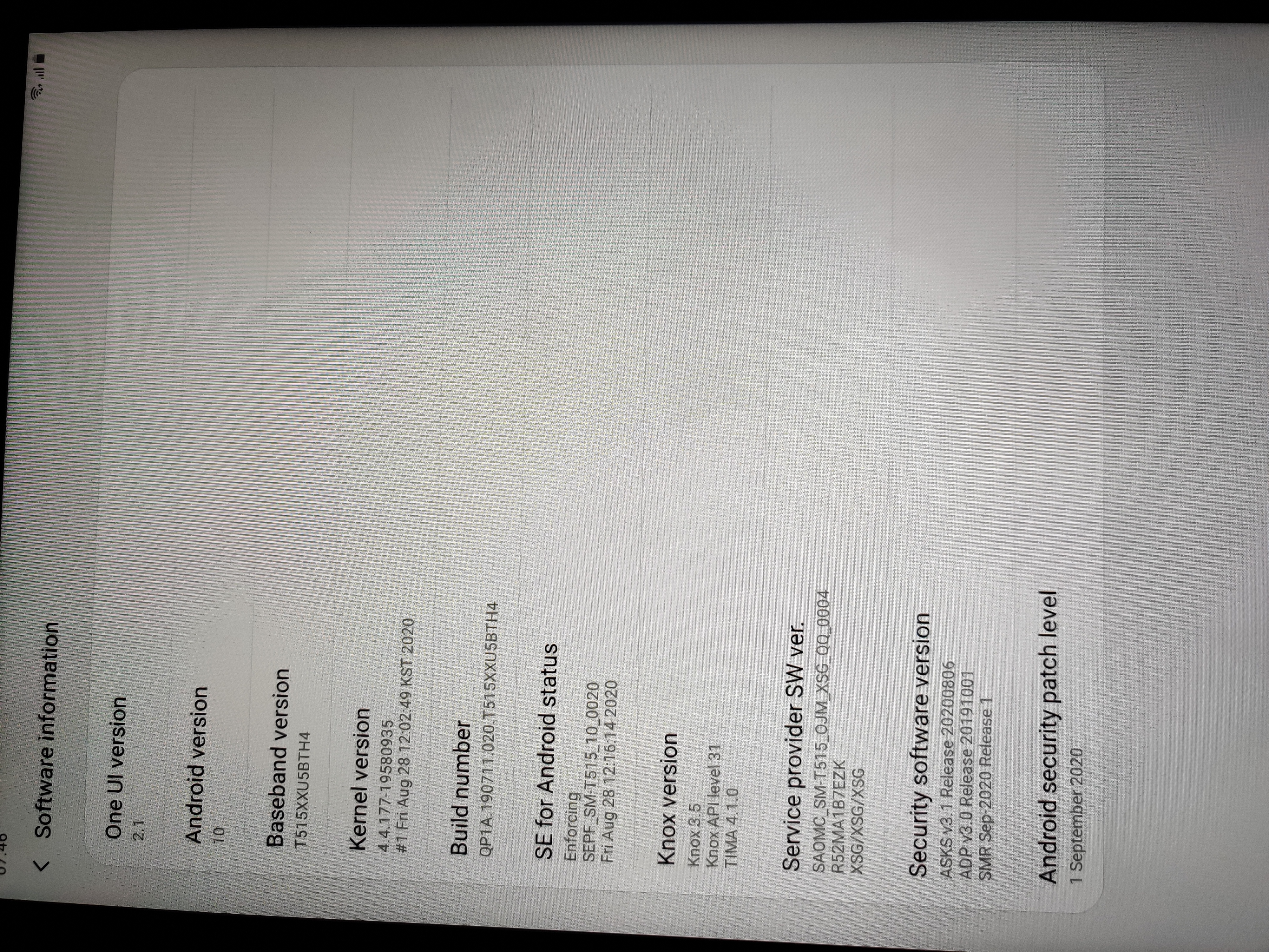

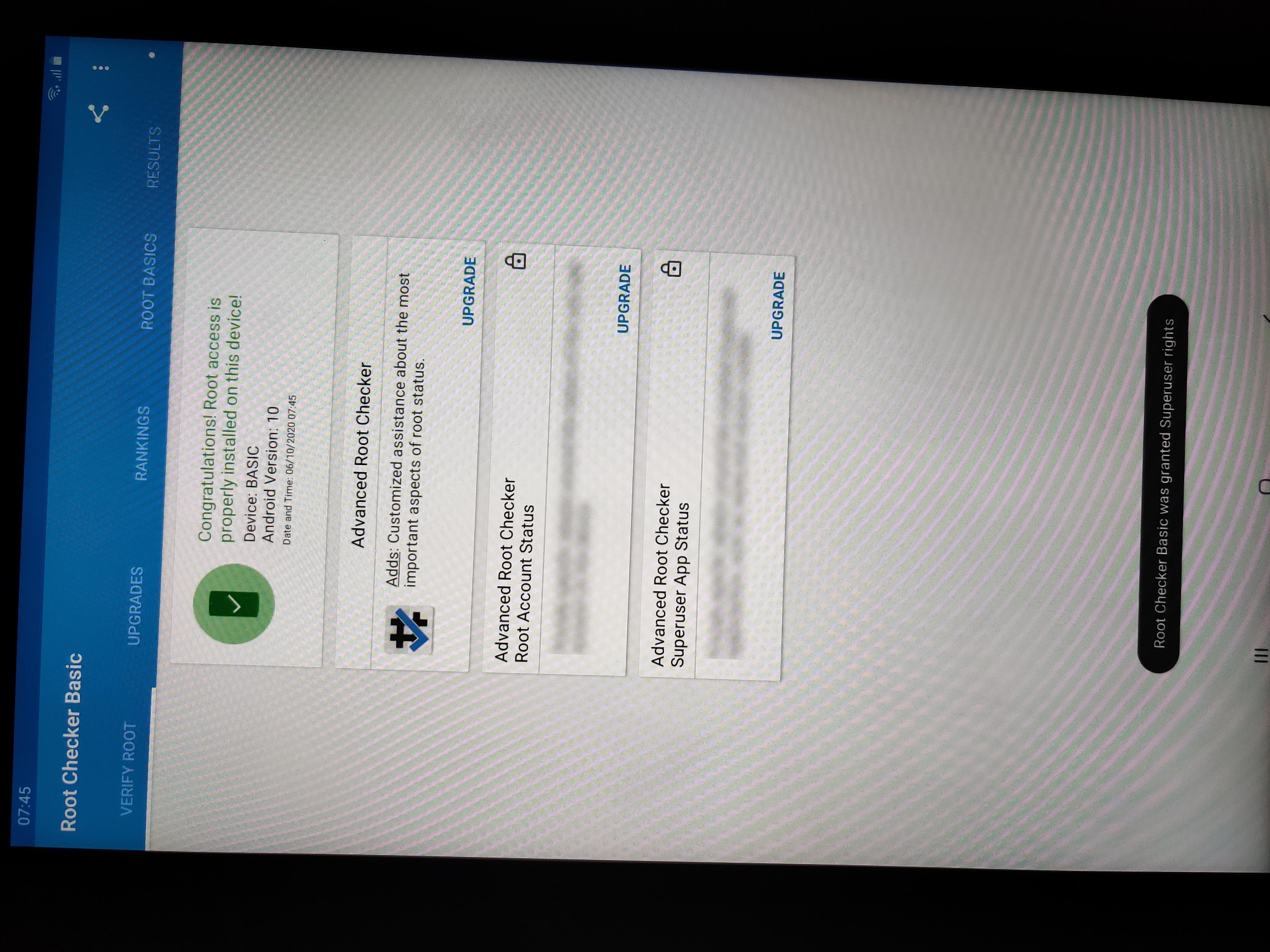

After 12 hours of trying to root Galaxy tap A SM-T515, I could root it on the latest update without twrp .
No bootloop!!
No failed on odin:D:D

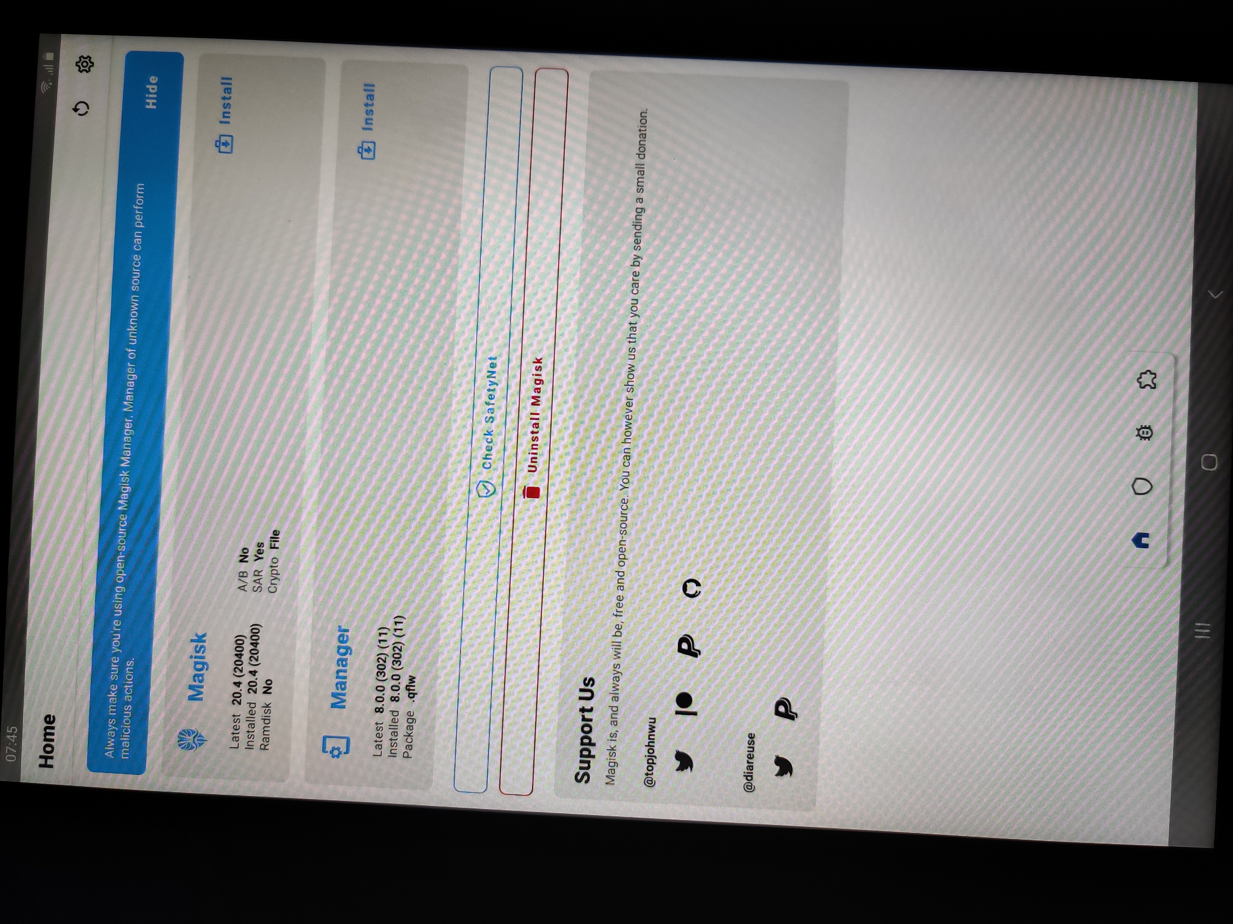

Root t515 u5 android 10
i rooted this devices t515 u5 android 10 in 45 min
no need 10 hours
just patch AP file with magisk 7.1.2
and flash Patched AP CSC and Bl with odin
No boot loop and no any error
the files is more than 2GB if anyone need i can share it in later
