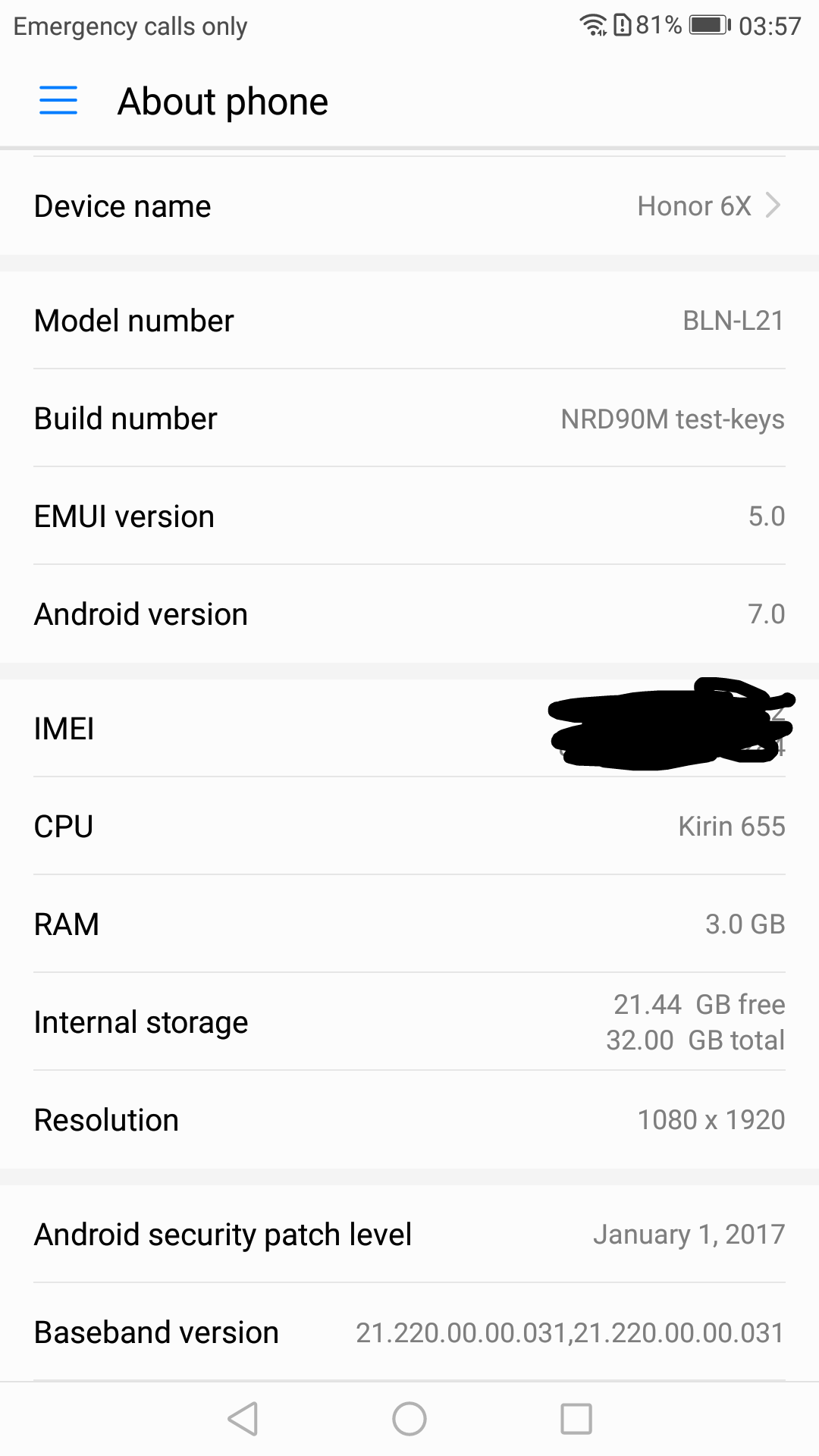

I am running Android 7.0 with EMUI 5.0 on my 6X, but logically this recovery doesnt work cause its for MM. So i tried this https://forum.xda-developers.com/hu...ecovery-twrp-3-0-2-android-nougat-03-t3511937 recovery from P9 Lite forums, and it boots but i cant mount storage there. Would it be possible for u to update this TWRP to Nougat for us? If u need any files from the Nougat build reach me out or if you want to know how i installed it

There is this website which lists all of the huawei updates. i downloaded the newest for our device there and installed the update.app (though i struggled a bit). but now i have a rooted emui 5.0 android 7.0 with system r/w and my only problem is that the recovery cant mount storage

can you send me screenshots of your emui 5??

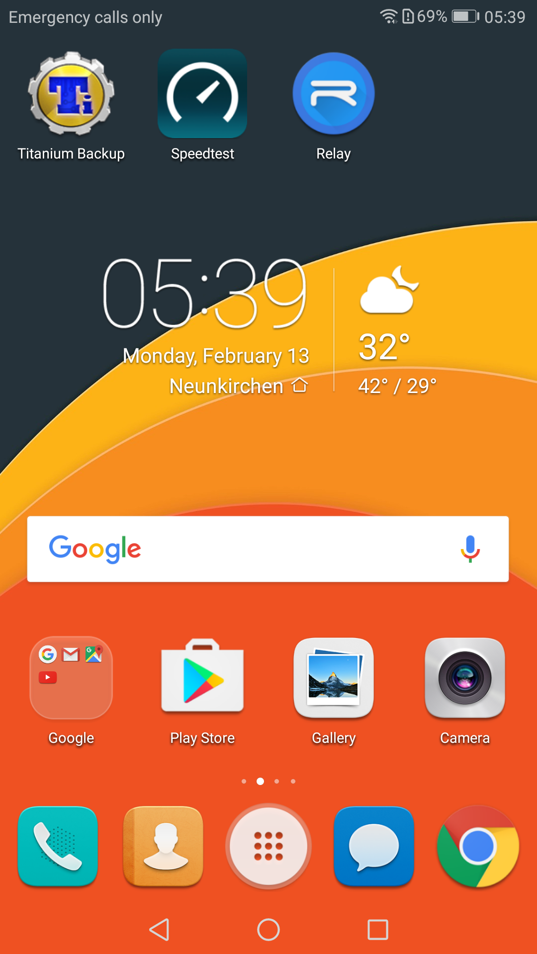

is it true that is has now an app drawer?? can I have a screen shot of your home screen and the link also
Yes it has one , I'll add an image. As for link, which link do you mean? If you mean the one to install the update its quite tricky and took me a whole day to get it working and i think it's still a test build with some bugs (for example I can't get magazine unlock to work)
