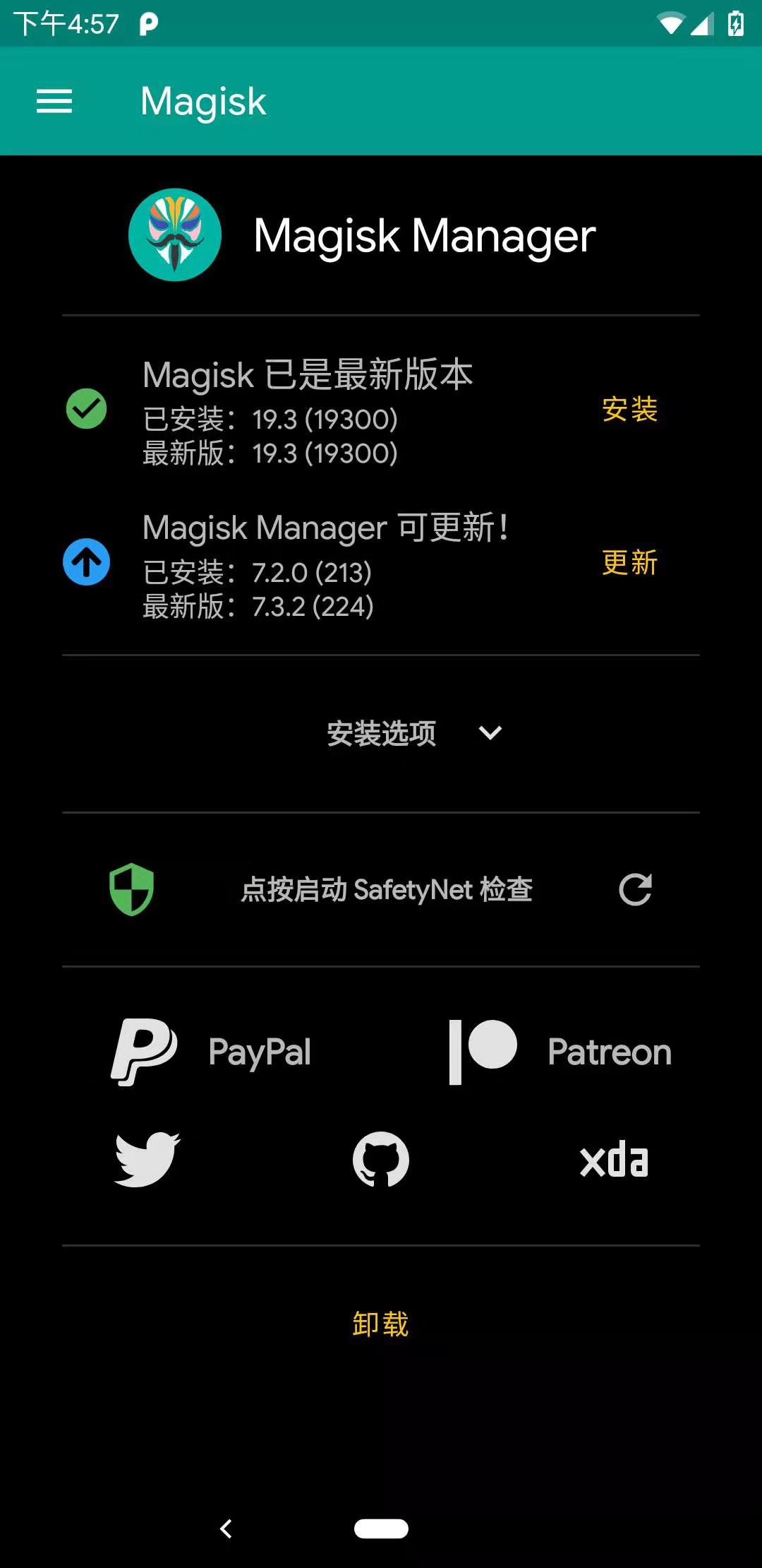

I am so happy that we don't need to root our devices through adb commonder but can via TWRP recovery!
firt of all, thanks to @ZVNexus, his work has made the recovery working pretty good and stable!
*Notice: you need to unlock your devide before.
instruction:
1.download the 'Magisk 19.3' zip file and put in your device.
2.flash TWRP recovery. just use these code:
<adb reboot bootloader >
when you get into bootloader mode, and then
<fastboot boot TWRP.img>
3.then the device will get into recovery mode automatically, flash the 'magisk 19.3' zip file which you put in your device before, just flash it
4.reboot, enjoy it!
