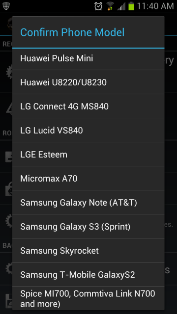

This may be a dumb question but, couldn't we just install ROM Manager and flash the CWM recovery with it, like I used to do on my EVO 4G?
thats what i did.
---------- Post added at 08:45 PM ---------- Previous post was at 08:41 PM ----------
mine sticks, just rebooted 2 times, and after booting into recovery again still version 5.8.4.6 which is latest.
installed via rom manager
about to try touch
