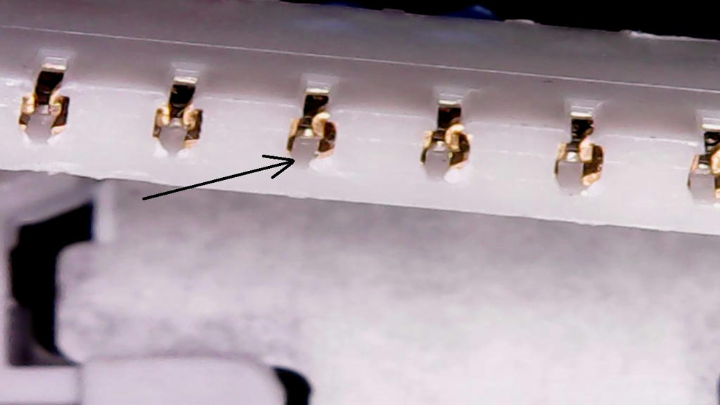

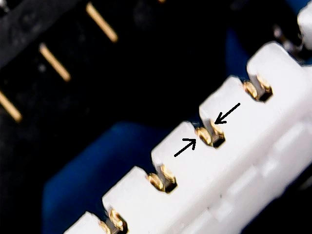

The battery connector with 6 wires only a minor source of flickering screen. You don't need to cut and solder it to the male connector.
The loose connector can be fixed by pushing the opening tip closer like this
Samsung fix it by adding the silver conductive glue like this
The major problem is from the male connector soldered to the mainboard. From my professional experiences, 90 % from cracked male connector ( black with 6 pins and soldered to mainboard ) , only 10% causing by loose female battery connector ( white with 6 wires ) : Samsung just simply use a conductive glue.
Trust me, I have fixed not a few but hundreds of them with this problem.
Reactions: squartascale

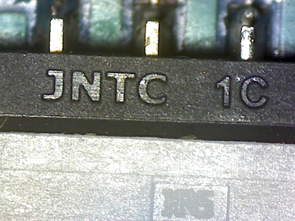

Videos won't help if you don't have experiences in soldering. There are many components close to these six pins, without experience and proper solder tip you will cause solder bridges on mainboard. I need a 10x microscope to see clearly what I am doing. You should bring it to a professional , they won't charge much for a 5 to 10 minute re work.
This is the original battery connector with hairline cracks
Then a re soldered battery connector which has more solders added to secure the connections
An experienced tech will routine re work on these two battery connectors first, even the screen is not flickering, because sooner or later it will come back with this problem.
