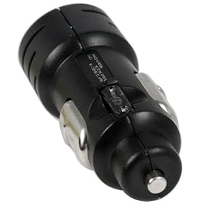

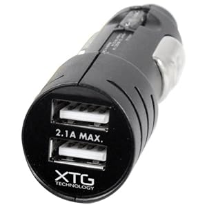

I'm looking for a car charger that would actually charge my 8.9 tab.
I have hooked up my tab to various USB sockets and im still getting the red X on the battery. I even tried a 2.1a socket. No luck. This is going back to amazon unfortunately.
XTG (Does not charge my tab)
"Ultra Compact High Output Dual USB Car Charger - 2.1A Output Ideal for Charging iPad, iPad 2, Galaxy, iPhone, HTC, Droid, GPS, and Other Tablets, Smart Phones and USB Powered Devices"
http://www.amazon.com/gp/product/B00470C35E/ref=oh_o03_s00_i00_details DOES NOT WORK for me.
(actually, i might keep it for my HTC evo. I like how its blade fused)
samsung galaxy tab 8.9 and XTG 2.1a car charger showing device is not receiving charge from the 2.1a usb charging port. XTG at fault?
samsung galaxy tab 8.9 and XTG 2.1a car charger on ac to dc bench test inverter. The XTG fails to charge while device is powered on. It will only charge when off. Even a standard USB port can do that.
Samsung galaxy tab 8.9 on wall charger showing proper charge receiving from wall charger.
So if anyone can recommend something that does work, please do let me know. Im trying to find something low profile instead of having to use a DC-> AC -> wall socket -> usb in the jeep. >_<
