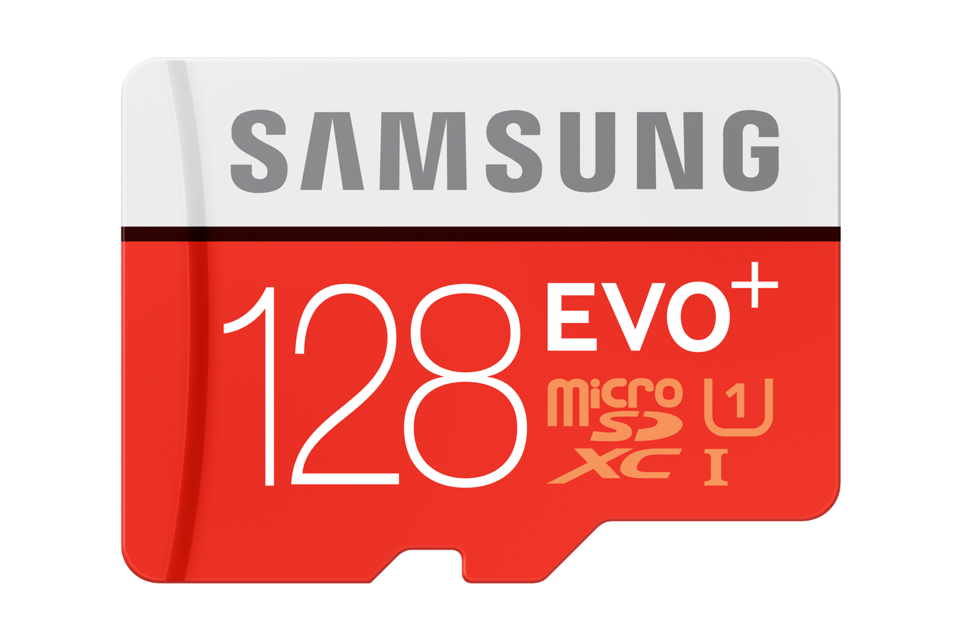

- 64gb Samsung Evo+ (UHS-I, U1)
A1 SD 64.66 / 22.30 MB/s (seq r/w) (http://forum.xda-developers.com/s7-edge/accessories/suggestions-microsd-t3321569/post65807311)
A1 SD 65.95 / 22.20 MB/s (seq r/w) (http://forum.xda-developers.com/s7-edge/accessories/suggestions-microsd-t3321569/post65807311)
