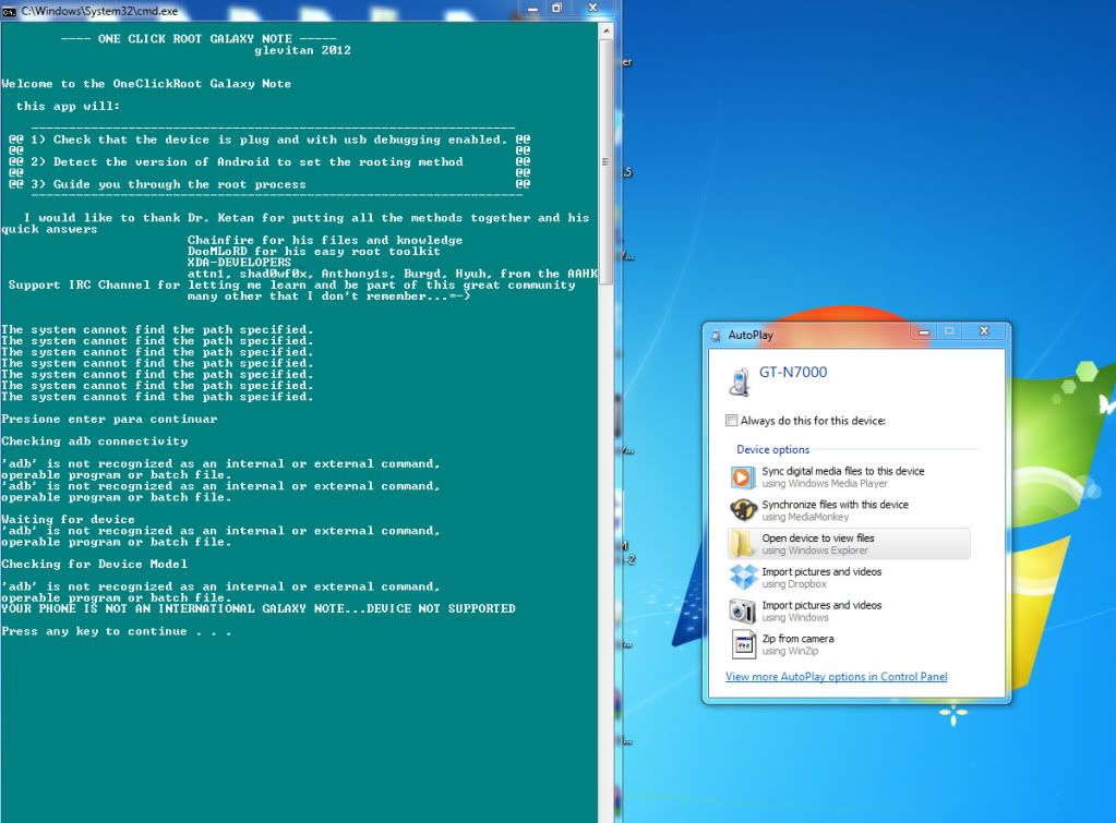

apparantly my GT N700 is not the international version and isnt supported. bummer
Is your device N7000 or N7000B? that is weird, I have tested many times with my HTC and my Note and works great.
Just a favor, would you send me the following info:
  1. Plug your phone with usb debugging on
  2. Open a cmd in the PC
  3. Type: adb shell getvar all
  4. Paste the outcome as code in here or send me a pastebin link
Just to check your model id...thanks for the feedback...
