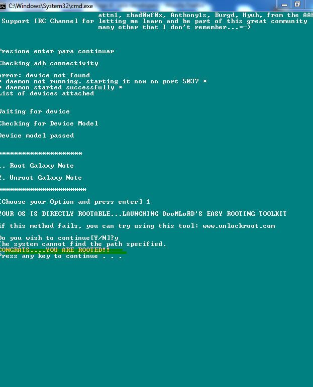

still no joy for me, going to try on laptop, only thing i can think of is i doesnt like 64 bit windows
That is weird. I have a laptop with 64 bit windows. Maybe you can try to install the commands and .dll's in the files folder directly in the c:\windows folder manually. That is where it should be installed. It worked for me and some other that have tried it so far. The files you need are:
adb.exe
adbwinapi.dll
adbwinusbapi.dll
wget.exe
fastboot.exe
md5sum.exe
Try installing that files and then rerun the script....
adb.exe
adbwinapi.dll
adbwinusbapi.dll
wget.exe
fastboot.exe
md5sum.exe
ill try it tomorrow and let you know
