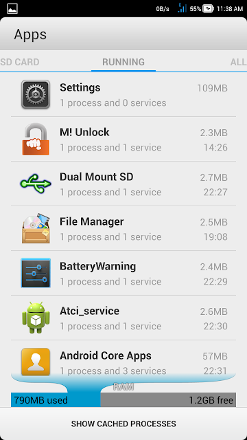

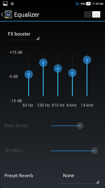

Finally Done Porting Lewa 13.7.12
Hey Guys :) Thanks Masters Shifu voetbalremco and Yuweng for help me always :)
I successfully port Lewa os from Lenovo S920 to My New UMI X2 :)
even all features working fine :p
everything means everything lewa theme working , lewa file manager mount both sd internal and external, Rooted with latest su 1.34
i post some screenshots here :) , i already posted my porting methods which way i port this lewa os too :D ,
-> for network replace stock firmware folder in system>etc> ( firmware here )
-> for Audio check my old post audio fix screenshot for any MT6589 device :)
-> for screen you must select Density of your original device specified likewise mine is 480 ( 1920*1088 ) so i add this line at end of build.prop
ro.sf.lcd_density=480
then save it and replace in rom before flash it :)
Thanks
Hardy
Screenshots of my device Lewa ROM ( Actually its UMI x2 , but i dint edit build.prop :p so its showing Lenovo S920 still :D )

Friend, can you post the equalizer + music player (including dex files) + soundFX folder (system/lib/soundFX) for me? I would like to have an EQ on my lewa aswell....
or..if you uploaded the rom somewhere, can you link it for me please ^^
@superbar ...please...read my post above...everyone keeps asking the same questions over and over here haha :good:
BHARDIK
May 27, 2012
741
546
123
Rajkot, Gujarat
www.hardikahir.in
i can upload it for you :) but hole ROM not possible....sorry having very slow 2G Internet only ,
i upload Muisc.apk+MusicFX.apk both are deodex and sound fx folder from system/lib/
Wait for my next reply
Thanks
Hardy
---------- Post added at 09:17 AM ---------- Previous post was at 09:10 AM ----------
dear Brick3d,
here is your files
in this package u get music+musicfx deodexed apk + soundfx file
You can get it directly from here
http://d-h.st/bzR
