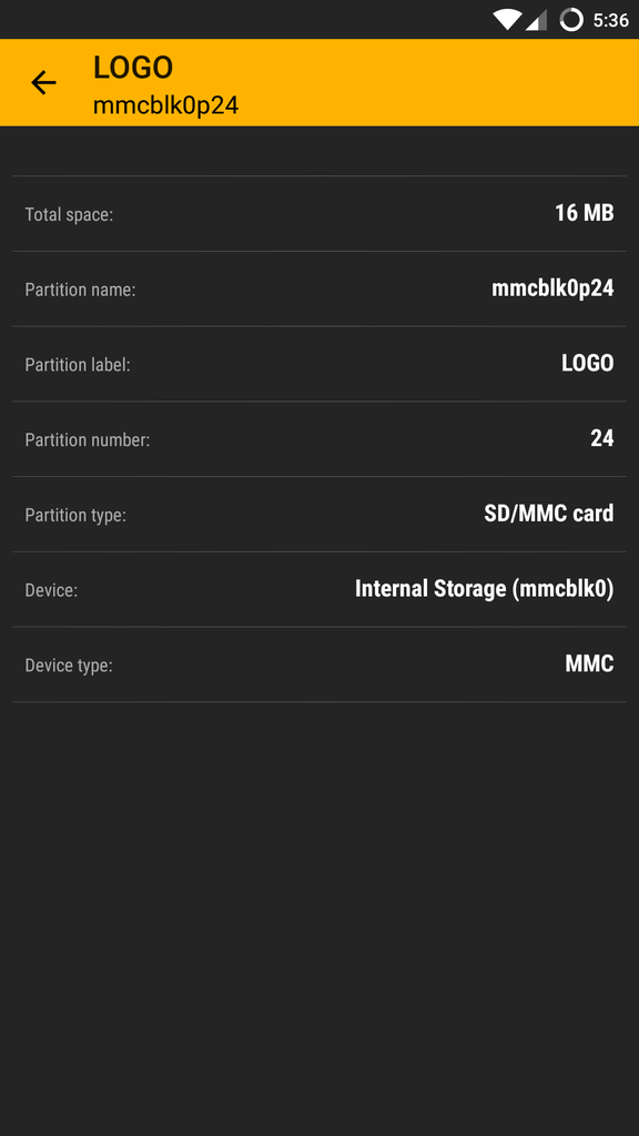

the LOGO partition is 16mb in size according to this programs root access information, plenty of play space :)
https://play.google.com/store/apps/details?id=me.kuder.diskinfo&hl=en
DiskInfo Screenshot Sample

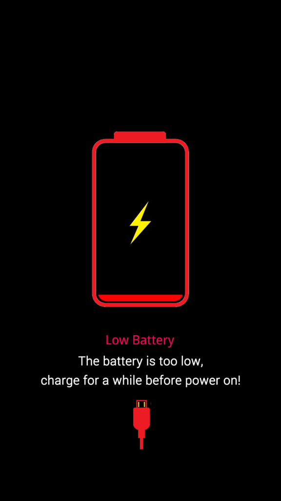

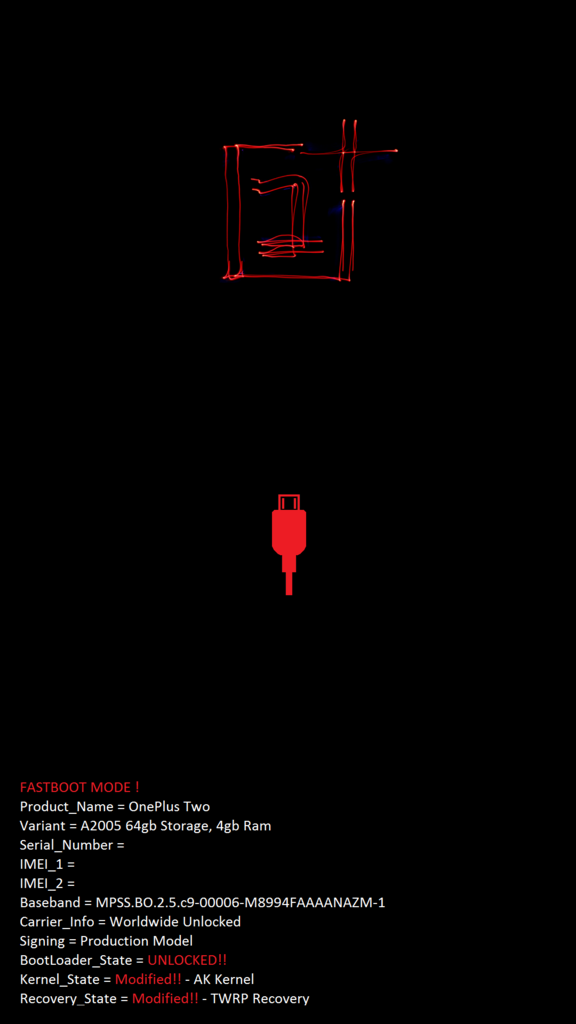

Here is a sample of my custom edited logo.bin contents
