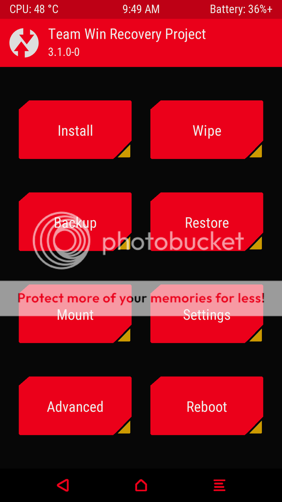

Hi! I read almost all post in here and I'm still confused about the rooting.
I got from Amazon USA this morning a new Honor 8 FRD-L04C567B360.
I was able to unlocked bootloader and flash TWRP 3.1.0-0.
My question is, how can I root the device?
I used before superSu, but with this TWRP all versions are failing with error "signature verification failed". I tried version: superuser-r275 (not working), superuser-r259 (also not working), and SuperSU-v2.79-201612051815 reboot my device but it does not root it.
What am I doing something wrong here?
Thanks!

Hi Guys, I woke up early this morning just to finish this ****.
Thanks for the help.
I made the device working again using the Huawei eRecovery, sorry @e_mc_square I saw your message too late, but thanks anyway!
I flashed TWRP 3.1.0 and is working fine., but now I stuck on the same step as last time.
I downloaded phh's SuperUser app from the play store and is not doing anything, also I downloaded the zip file superuser-r275.zip from here: https://superuser.phh.me/ and when I try to install using TWRP it doesn't work, the installation fails.
What am I missing?
Thanks again!
