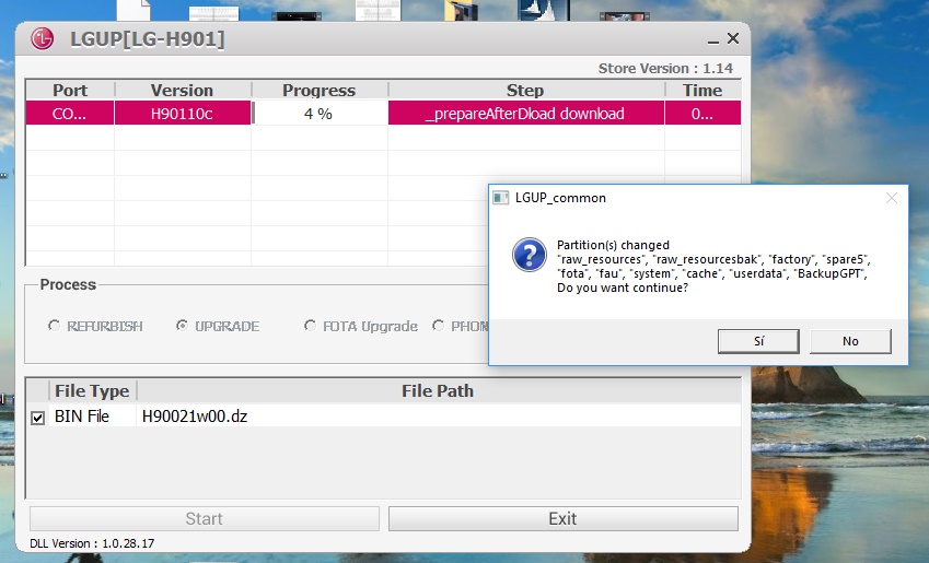

After spending 2 days and trying and trying I finally got the solution. The smartphone in the sticker under the battery has model number "h901" but I think that for one reason or other it's "h900" that's why we will treat it like "h900" and I will tell you how to flash even if model is different. Make sure you have vs990 motherboard model(it will take you 5 minutes remove the screws and verify). First of all download:
Firmware: https://lg-firmwares.com/downloads-file/3862/WEB_H90021w_00_0921.kdz.
LGUP: http://oceanhost.eu/dl959drhehp3/LGUPV10.rar.htm
Uppercut(you will need this if you have problems opening LGUP: https://forum.xda-developers.com/lg-g5/development/uppercut-lgup-loader-g5-variants-t3511295
Software to extract "dz" file from "kdz" file(this will allow you install any firmware on different model number): https://dl.xda-developers.com/3/1/3....zip?key=uWmelyLw3rVRER88X_xl3A&ts=1548509744
Steps:
1) if you have the smartphone in qualcomm mode then follow this guide until step 6: https://forum.xda-developers.com/verizon-lg-v10/help/lg-vs990-unbrick-via-qfil-t3739299
2) Open WindowsLgFirmwareExtract software, on "kdz file" section click "open" and look for WEB_H90021w_00_0921.kdz file you downloaded, check h90021w00.dz file and click "extract KDZ file" wait for the process(you will find the file if you click again "open", just cut it and paste it on desktop)
3)Now you should be in download mode, open Uppercut and then it will open automatically LGUP.
Check UPGRADE and in file path select dz file you pasted in desktop. Wait process end you should have booted your LG V10!
Marshamallow firmware has bugs. Fingerprint for example doesn't work. But this is the only way you can boot up you phone.

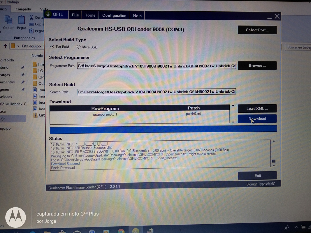

Hi greeting from Malaysia, 1st for all I'm sorry for my bad english.
Recently I managed to unbrick my LG V10, originally it was H901 T-Mobile, android 5.1.

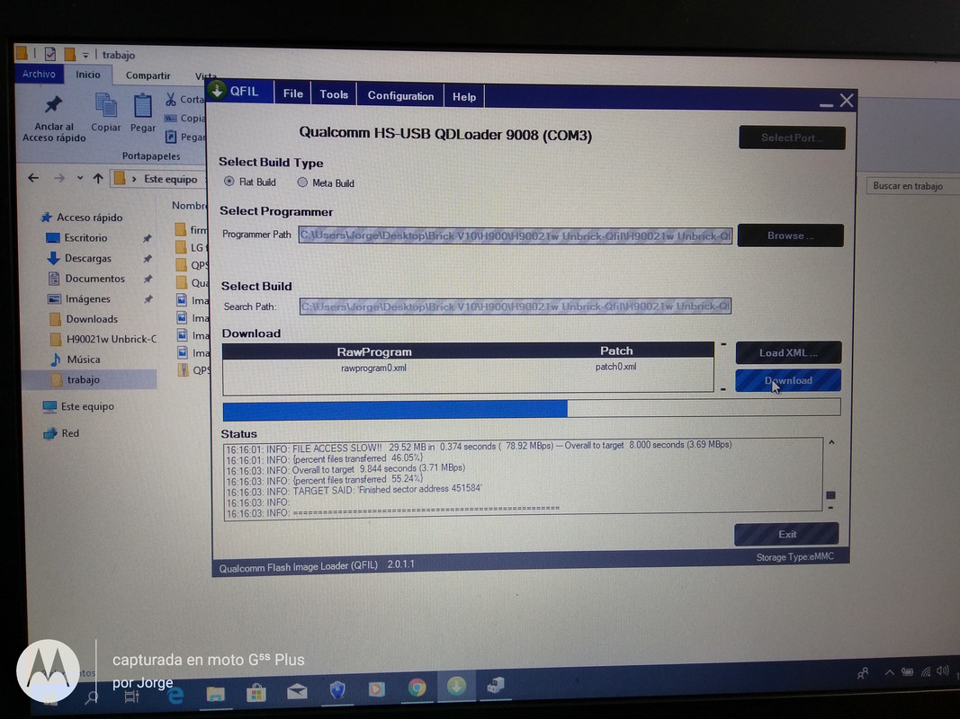

1. I use QFIL to unbrick the phone. Use the files (H90021w Unbrick-Qfil.zip) designed for H900 (download somewhere from xda, I already forgot the link because too many try & error. It took me 5 days to figure out on how to unbrick my phone).

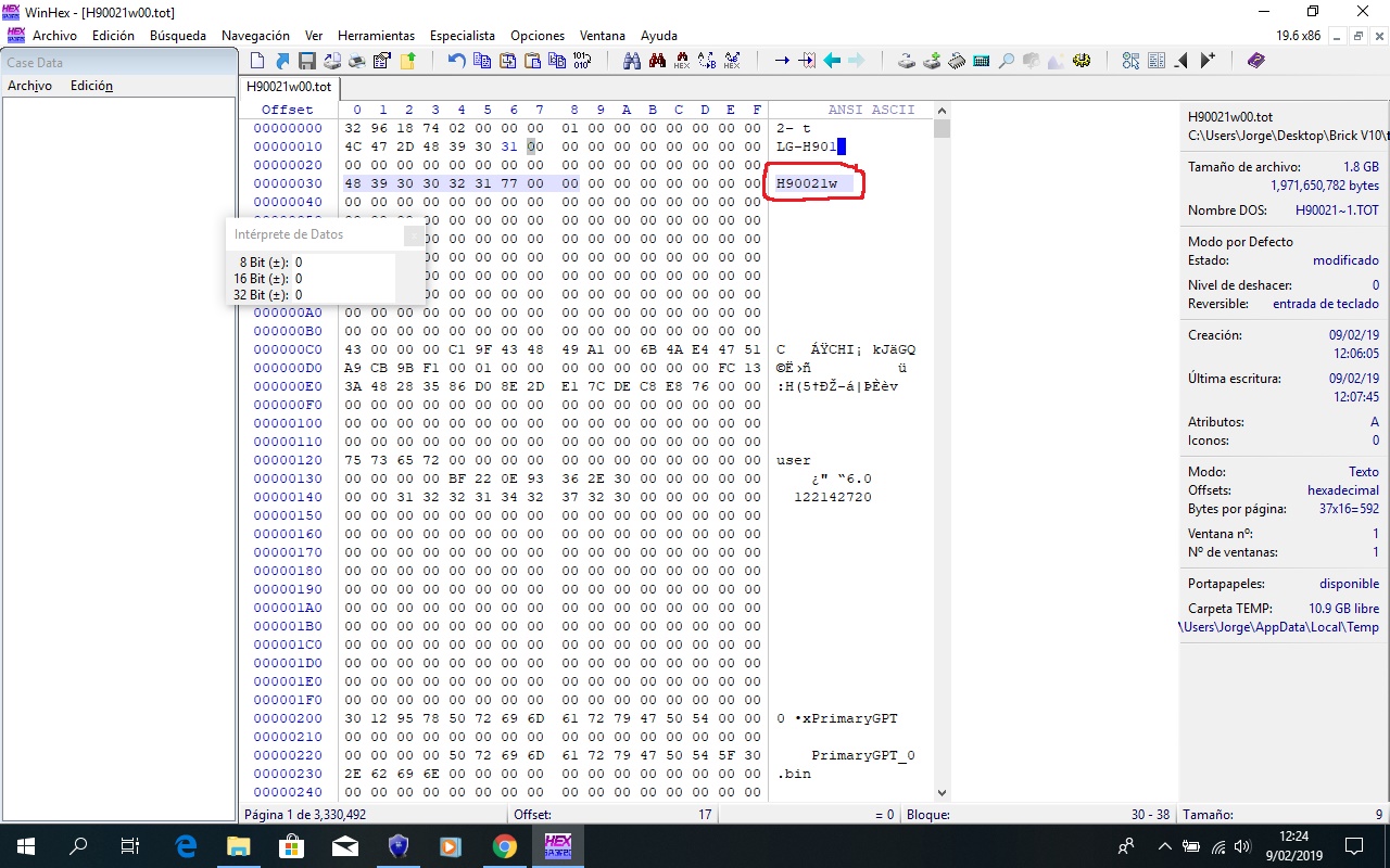

2. Then I use WindowsLGFirmwareExtract-1.2.5.0-Release to extract the kdz file to dz.
3. After that rename the .dz file to .tot . Use WinHex to edit the file, search word H900 and change to H901 because LG UP detected my device as H901. Save & change back the file from .dot to .dz
4. Lastly use LG UP, choose upgrade... done! LG V10 is back to life.

Bravo!, what WinHex version have you used?
QuickZero
Feb 8, 2019
5
4
Hi, I'm in this part. But I have a question when LGH90021W appears, should I also change it to LGH90121W?
No need. Just change the 1st one.
---------- Post added at 03:30 PM ---------- Previous post was at 03:22 PM ----------

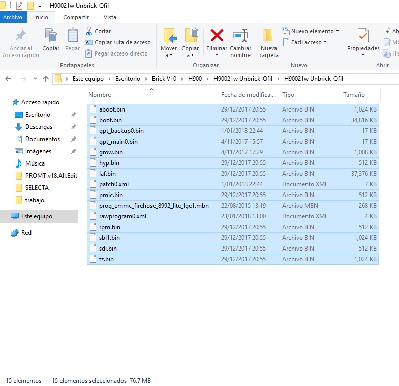

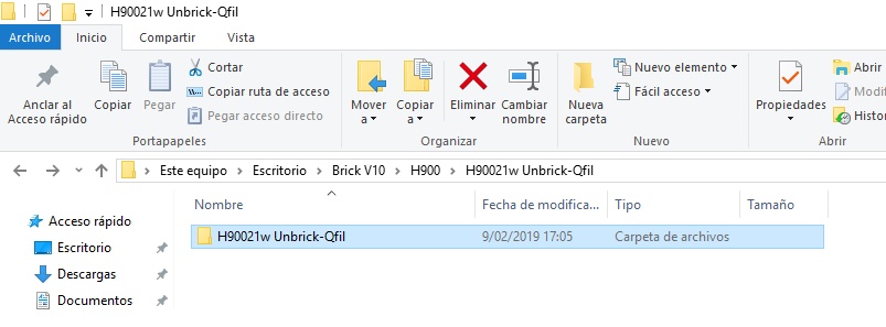

Now I get this:
Your QFIL folder should contain:
1. aboot.bin
2. boot.bin
3. gpt_backup0.bin
4. gpt_main0.bin
5. grow.bin
6. hyp.bin
7. laf.bin
8. patch0.xml
9. pmic.bin
10. prog_emmc_firehose_8992_lite_lge1
11. rawprogram0.xml
12. rpm.bin
13. sbl1.bin
14. sdi.bin
15. tz.bin
*the name may be different base on the "patch0.xml"
Total folder size: 76.7MB
1. aboot.bin
2. boot.bin
3. gpt_backup0.bin
4. gpt_main0.bin
5. grow.bin
6. hyp.bin
7. laf.bin
8. patch0.xml
9. pmic.bin
11. rawprogram0.xml
12. rpm.bin
13. sbl1.bin
14. sdi.bin
15. tz.bin

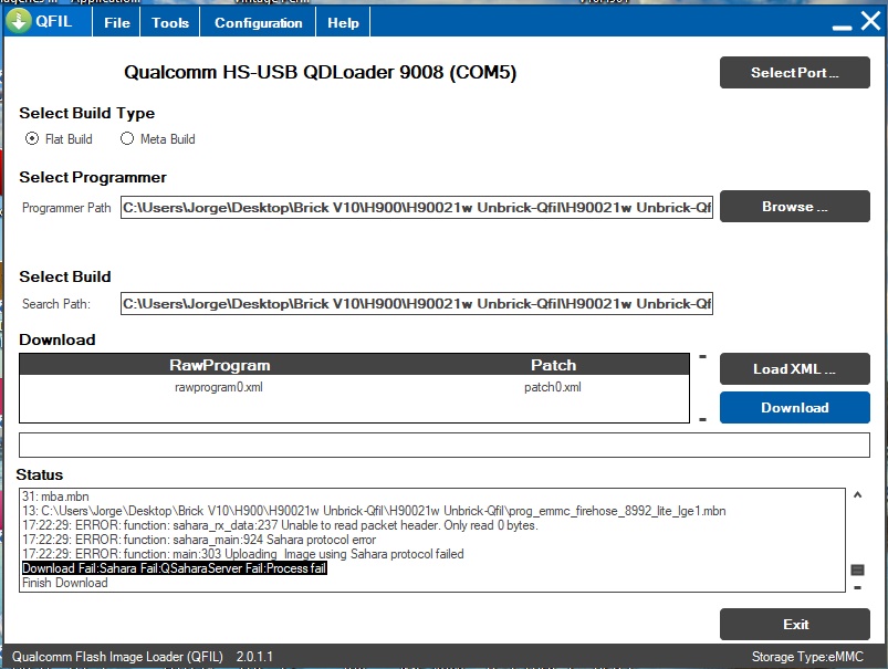

Yes,....
What am I doing wrong?

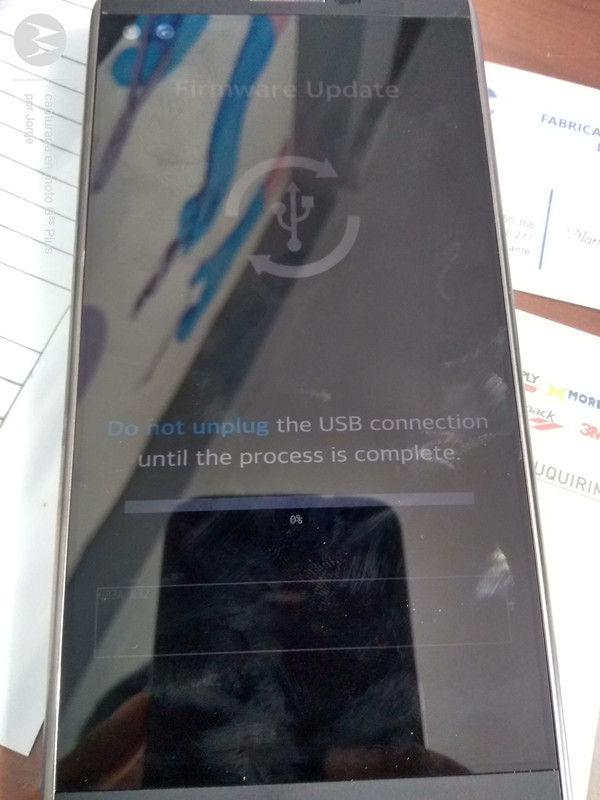

Hi guys, it worked with the suggestion to change port, there the images
---------- Post added at 09:54 PM ---------- Previous post was at 09:52 PM ----------
But I have stayed here. What do I do now?
