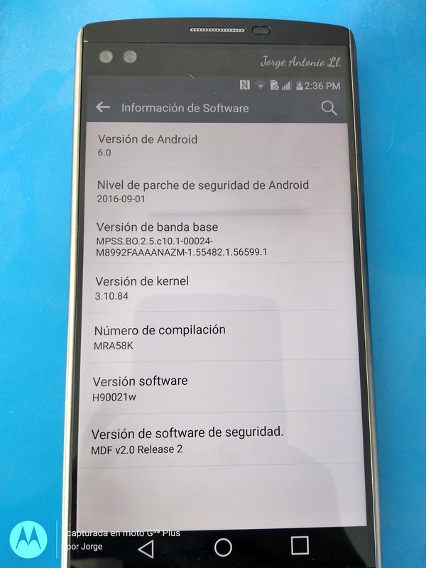

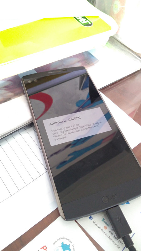

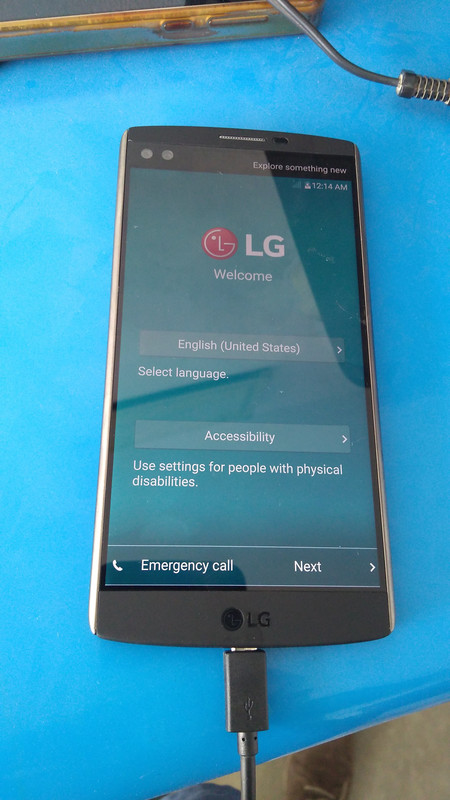

It worked, now I have LG V10 live again. Thanks to everyone for the guidance and QuicKZero who found the solution.

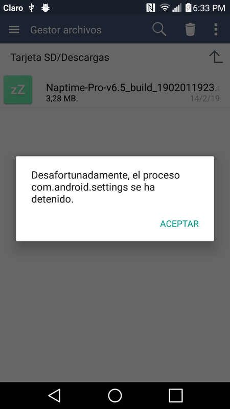

Unfortunately there is a detail and it is that it does not let me install any third-party application and I can not configure to install applications of unknown origin. Is there any solution for this?

Hi Joranto, you did it!
So far I didn't find the solution yet for those issue.
I've some idea but too scared to try haha... because LG V10 is my primary camera, as long as camera and apps from play store are working, I'll be fine ?

Good evening with everyone. I found a way to install applications by ADB, successfully when we want to do it outside of the play store. However, uninstallation following the same method is not possible, the phone is restarted but the application is not uninstalled. I share the video that I recorded doing the process.

ADB method: (enable Developer Option & download ADB)
How to Enable Unknows source (third party/apk):
adb shell settings put global install_non_market_apps 1
adb shell settings put secure install_non_market_apps 1
How to install apk file:
adb install something2.apk
How to Uninstall apps:
adb shell
(enter)
pm uninstall -k --user 0 com.whatapk
*Please install App Inspector from Google Play to know what com.something2...
Hope this can help any H901's survivor here hehe... :D

QuickZero once again I am grateful to you, I managed to uninstall applications with your method by ADB.

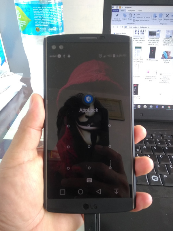

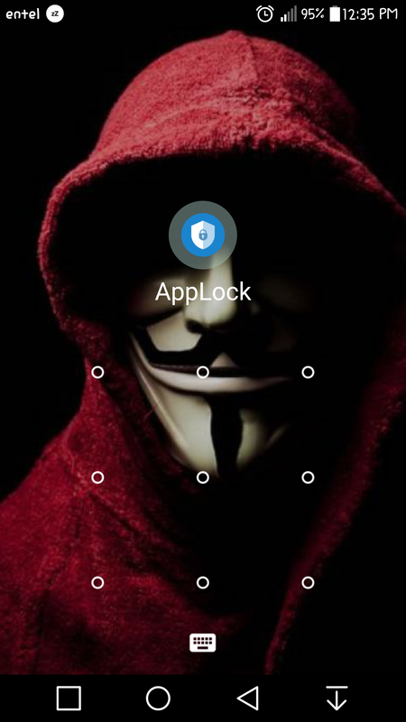

The problem to set fingerprints seems to have no solution, however, in order to give security to the screen, the AppLock application can be used, with this I have been able to establish a way to lock the screen.
El problema de configurar huella digital parece no tener solución, sin embargo para dar seguridad a la pantalla se puede usar la aplicación AppLock, con esta he podido establecer una manera de bloqueo de pantalla.

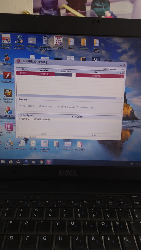

I have managed to install H90021W firmware with patched LGUP but the phone stucks on AT&T logo.
---------- Post added at 03:53 PM ---------- Previous post was at 03:51 PM ----------
I've managed to install H90021W firmware on my H901 with VS990 motherboard but on boot it stucks on AT&T logo. Any sugestions?
joranto
Nov 10, 2018
28
You are in bootloop. The Solution is to change another motherboard or reballing. But, have you install the modified firmware H90021W?
