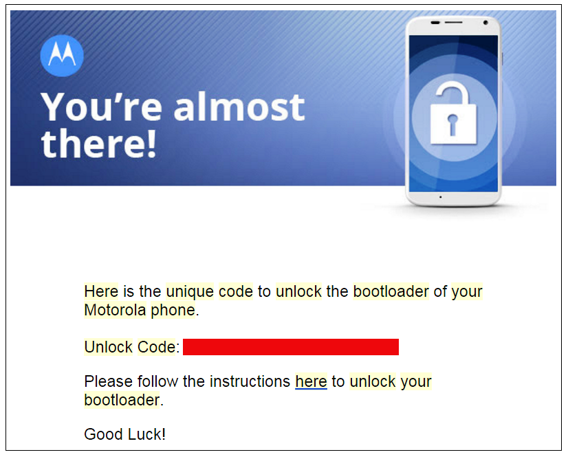

Before anything, go to the Motorola website and unlock your bootloader.
Unlocking the Quarks -- "international" Moto Maxx XT1225, Moto Turbo XT1225, U.S. Moto Maxx XT1250 -- is FREE, via the Motorola website.
UNLOCK YOUR BOOTLOADER
https://motorola-global-portal.custhelp.com/app/standalone/bootloader/unlock-your-device-a
You release Motorola from any liability, get a code and unlock your bootloader.
If you get an error message at this step that your phone is not eligible, then you have typed in something wrong (or you have a Verizon Droid phone). Helps if you Google how to copy and paste from Windows command window. There's a LOT of alphanumeric characters you have to type. First time I tried to unlock my bootloader I mis-typed something. :crying: Copying and pasting from the Windows command window fixed that problem! :good:
You'll get an email with the bootloader unlock code. The email will also have a link back to the instructions. But the code is what's important.
You will receive this fairly instantly. If you don't get it, make sure you checkmarked you agree to all the conditions. Also check your spam folder.

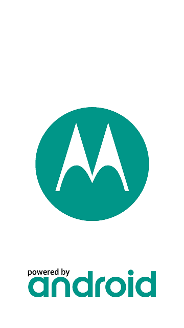

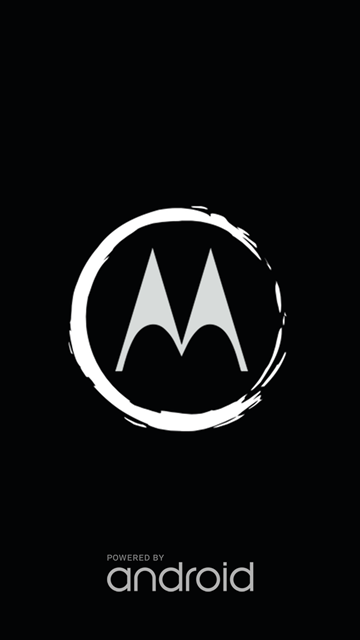

Remove annoying bootloader unlocked warning
Motorola insists upon telling you that you unlocked your bootloader every time you reboot your phone. This is the static logo you see before the moving boot animation starts, and Motorola replaces it with an UNLOCKED bootloader warning. Yes, I know -- I unlocked it on purpose!
Replace that annoying warning with something cool looking... I have attached FIVE choices with Motorola logo!
* Black and White
* Dark Google ATAP
Graphic for this above was used from this Moto X Pure thread by @XDleader555 -- but I adapted it for our Quark so it wouldn't be upside down. ;) All the other bundled graphics in the bin file like "recovery", "bootloader" are taken from the Black & Teal logo below. However the "splash screen" is this artistic black & white boot logo.
* Black and Teal
*White and Teal
* Black and Red
(The last three with color are custom graphics made by @fenix3nk0r3 from this thread. I am using the black and teal on my daily phone.)

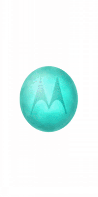

Flash new boot animation
FLASH NEW BOOT ANIMATION.
1) Google Bootanimation 60fps for all QUARK
There are plenty of boot animations available. I like this one...
Looks like this:
But a LOT smoother in real life
See attached file. This is a TWRP flashable zipped file. Download and flash it in TWRP.
Do NOT unzip it! Just boot into TWRP recovery and flash it.
Thanks to @LuanGuima14 for the file!
[emoji23] I made a zip containing the bootanimation that google uses the nexus at 60fps and also bootlogo the Droid turbo has dark background
____________________
Also we now have this:
2) Motorola stock "Spinnning World"
Thanks to @metpolds from this post.
Yes, it works on our Quarks. I just flashed it in TWRP recovery to test.

TWRP-FLASHABLE: REMOVE ANNOYING BOOTLOADER UNLOCKED WARNING
This is the static logo you see before the moving boot animation starts.
Due requests, I have attached TWRP-flashable files with boot logos already inside. No need for a PC!
NOTE: Flash one of these boot logos as a separate TWRP session if you are also flashing the boot animation. For some reason both cannot be flashed in the same session.
___________
* Black and White
* Dark Google ATAP
* Black and Teal
*White and Teal
* Black and Red

I was trying to get the bootloader unlocked, but I still haven't received any code by Motorola. How long do they usually take to send it?
I tried to contact them too, but their site is terrible, every device that I try on that site has issues, in can't even send a question or get into the chat, the buttons don't work
ChazzMatt
Nov 30, 2010
18,308
14,151
253
Atlanta, Georgia
It's fairly instant. Did you agree to the conditions?
Check your spam folder.

Garden98
Oct 20, 2016
6
Thanks, it worked. I can't believe I had to try three times.
Motorola site is still sh*t for help ahah
Reactions: ChazzMatt

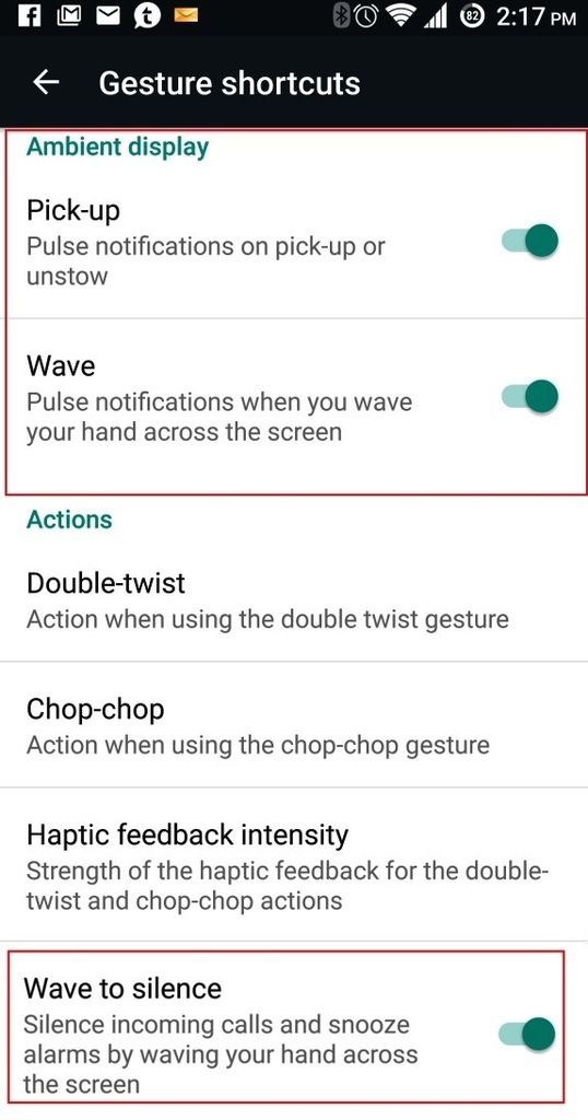

QUARK AMBIENT DISPLAY SETTINGS
EDIT 2: I flashed the Resurrection Remix ROM (http://forum.xda-developers.com/moto-maxx/development/rom-resurrection-remix-t3316232) using TWRP and my phone works, but I losed the active display :(
For the active display, in CM-based ROMs it's called "Ambient Display". Our CM dev @Skrilax_CZ, put a lot of effort into coding it so it works with the the Quark (Moto Maxx/Moto Turbo/Droid Turbo) IR sensors very much like Moto Display.
All the other ROMs, like Resurrection Remix, Bliss, etc use the same coding.
It's a lock-screen notification system. You will not see any notifications if you display is not locked when it is off/dark/sleeping.
In Settings,
  • First, you need to turn on Ambient Display.
  • Then, you need to configure the actions of Ambient Display. For example, some want to see notifications when they wave their hands over the phone, some do not want that action.
Below are the Ambient Display settings screenshots I took when I was using CM12.1. I am now using Resurrection Remix Marshmallow, like you. The settings are either identical or very, very similar.
____________
_____________
2)
___________
3)
______________
______________
4)
In Lock Screen, you need to have some sort of of screen lock, even if it's just swipe/slide lock. Either swipe, pattern or PIN. You can't choose "none". I choose pattern, but it's up to you.
IF you choose swipe, you may accidentally unlock your phone if you keep it in your pocket. PIN or pattern is better, in my opinion.
In RR, these settings below are under "Security". In CM12.1 it was under "Lockscreen".
Also, helps if you have "Automatically Lock" and "Power Button Instantly Locks" Some people put a delay on those for some reason, and then Ambient Display isn't going to show you notifications on the dark screen because the Display isn't actually locked.
NOTE: After you turn on all the other options, sometimes it's best to then turn off Ambient Display, then turn it back on to make sure it recognizes the other settings you have enabled.
Reactions: sebamerca
