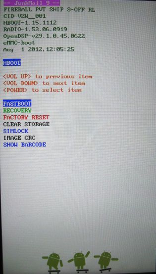

With the tool and this plug-in, you can easily create a custom HTC firmware zip for the HTC Droid Incredible 4G LTE containing a custom bootloader image. You will be able to edit the *** UNLOCKED *** (or "-- DirtyRacun --") text on the top to whatever you want it to say, change the S-OFF to S-ON, change the bootloader's minor version number, update the bootloader's date and time stamp, and either hide or customize the splash screen disclaimer. Using this tool to change S-OFF to S-ON changes only the text on the screen, it does not change your s-off status of the phone. Same goes for "locked"/"unlocked"/"Relocked" so be careful to remember the correct state of your phone.
Choosing the "Stock" option, the tool automatically sets your banner to say *** LOCKED ***, changes S-OFF to S-ON and hides the HTC Development Splash Screen Disclaimer.
This program will NOT flash the zip for you, but it will create the PJ53IMG.ZIP and save it your computer. From there, you simply copy it to your sdcard and flash the zip yourself in hboot.
The process (flashing a new bootloader) is dangerous and may possibly brick your device if done incorrectly. You have been warned

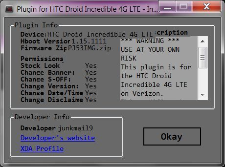

App Screenshot
Screenshot

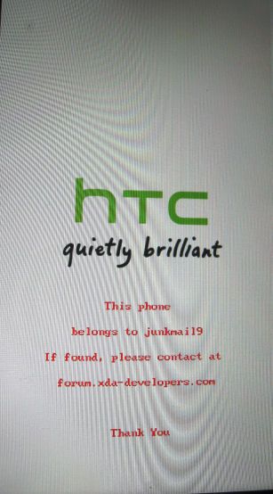

I created several versions of the plug-ins, so you can choose which hboot you'd like to customize and install.
This tool works well with phones which achieved s-off through the DirtyRacun process or are s-off and relocked through other means. If you have a development s-off phone that is truly still locked (not re-locked), let me know. This requires a different plug-in, but it has been done - one of my testers had one of these phones. If you have achieved s-off through another method, your results will vary, but the plug-in can be tweaked for your phone so please let me know if you need something different. The main difference will be that you won't be able to change the text in the magenta box.

This plug-in will allow you to use the RegawMOD Bootloader Customizer written by regaw_leinad.
App Screenshot
Screenshot
