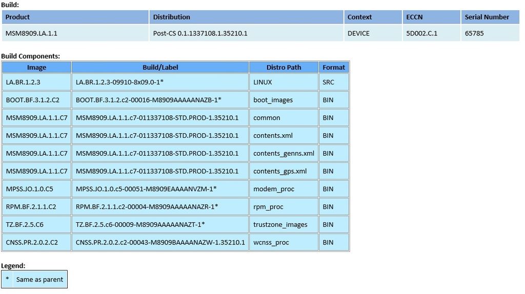

CAF Source
Ok so if your lucky enough to get what you need.
Then get the CAF source. ( WHAT Manifest / Branch ?? )
So then you need to look for the CAF Manifest "RELEASE"
LA.BR.1.2.3-09910-8x09.0-1*
https://wiki.codeaurora.org/xwiki/bin/QAEP/release
This one is a exact match. We will start with it. However we could very well use a newer release as well.
For now we will stick with the match. We can expand our horizon later.
September 03, 2015 LA.BR.1.2.3-09910-8x09.0 msm8909 LA.BR.1.2.3-09910-8x09.0.xml 05.01.01
First you must have installed git.
Then you can download the source by doing.
repo init -u git://codeaurora.org/platform/manifest.git -b release -m LA.BR.1.2.3-09910-8x09.0.xml --repo-url=git://codeaurora.org/tools/repo.git --repo-branch=caf-stable
repo sync

Template Rom
Ok so this will be a whole lot easier if we have a template rom to follow as we build our rom. We are creating nearly the same exact thing. The best part about this rom is it is built to flash a few different ways. Including with QDL9008 mode. This rom is specifically for the msm8909 chipset and nearly the exact same release that is currently on our device.
Perfect :D
It gets even better. I guess Longcheer releases all the source files with there updates.
This is exactly what we have here. We have everything you would have after compiling the rom from source.
And everything you would have if you built all the Qualcomm Images as well. This is the full meal deal.
Every last file is there and all of the tools you need to package flashable roms, ota, updates.
Even better this is a user-debug version.
Even More Better its only signed by Qualcomm Test Keys. And the Keys are included. :cowboy:
So this thing is the cream of the crop. And fully compatible with our device.
We can cherry-pick what we want and use it on the Desire 526..
In order to complete our project we need certain qualcomm tools.
They are included in this PUBLICLY RELEASED Official Update From Longcheer.
That means we have a legitimate way of having these tools that is not in violation of any license. (ITS A PUBLIC RELEASE :silly:)
Make sure you look inside every folder and remember where things are.
This is a msm8909 developers goldmine. I will reference this rom a lot in the future.
Unfortunately Need Rom will require you register. But it's free.
I will try to upload this somewhere.
