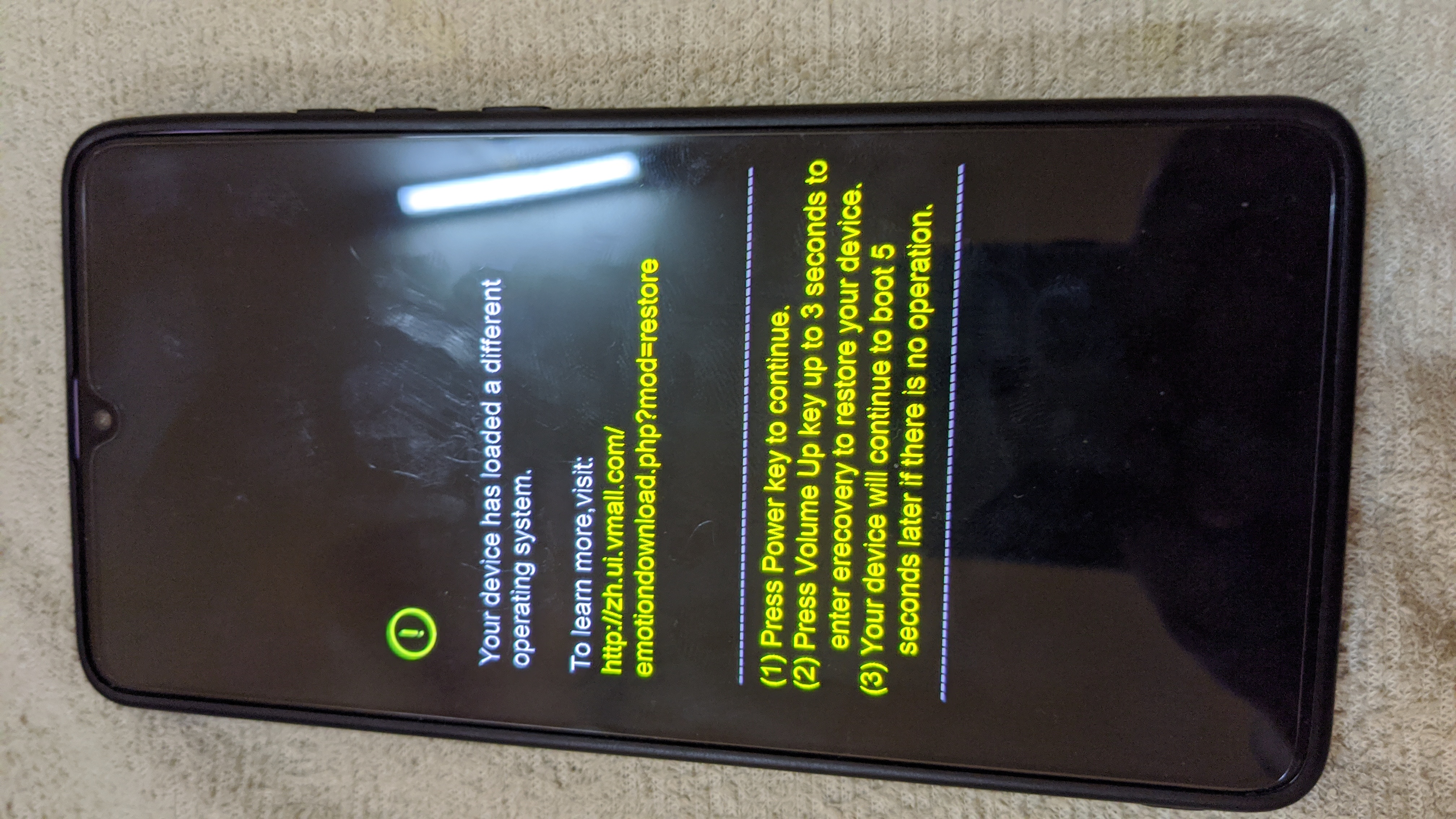

your device loaded different system please Please help

@virusman222
Your device is not a hw/spcseas C636.
Use 'fastboot getvar vendorcountry' to get your device vendorcountry.
Then flash accordingly the right region emui10 cust&preload for your device's vendorcountry.

Similarly to the OP, my phone said C636E3 in the version build... I cannot check it anymore since it always says now 'invalid operating system'...
I dont know...
If you already have softbricked device it doesnt harm your device to try other versions than 636.

@virusman222
OP's and others devices on this thread are now fixed with correct emui10 firmware for their region.

I'm having same type of issue that Hisuite has caused. I purchased the Mate 20 X from someone which is supposed to be l29 global. Hisuite told me I had an update, did it and now get your device loaded different OS.
I feel I just lost $700
Im not even sure what my vendor is on this as it happen all to quickly.
Erecovery gives error via wifi method

@virusman222
I have vendor hw/eu via fastboot i am assuming thats C432? Also my issue is Hisuite itself updated my mate 20 X to something it wasnt supposed to be and have these problems https://imgur.com/a/8iLsOlv

Hello,
First of all, I'm sorry if I'm not in the right forum, but on the Mate 20 Lite forums, I'm not getting any responds...
I have a Huawei Mate 20 Lite, SNE-LX1 C432
I upgraded to EMUI 10 using the sd card update method a while ago, and ever since when I boot the phone "your device has loaded a different operating system" shows up.
I searched every thread I could, even this one, and tried a lot of things, but I just can't fix it...
Every time I download a firmware for the SNE-LX1 C432 and unzip it, I always get the SNE-LO1 cust file and preload file, but I can't find the SNE-LX1 cust file and preload file anywhere.
Does anyone know how to get the right cust file and preload file?
Any help is appreciated...
