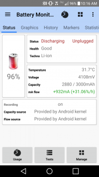

I'm sorry but the Mah is either Locked by the OS Kernel or theirs a Chip on the Motherboard telling the phone that cause no matter what battery i have other then the stock it doesn't say other than 3000mah. Look at my Thread as i have a Linked App to where you can edit the Mah in the App to whatever battery you have. It's the First Post

The app being battery monitor widget? I'm expecting my 9000mAh battery in the mail today, so just trying to get ahead of the game....

Well of course not. You need to be rooted to change the Mah if it's possible in the kernel or wherever the battery capacity is held at

I think its on the kernel side . tried everything but i think for whatever reason the mah rrading of the kernel still the same as 3000mah. When th battery resches 2% i just have to unplug the batgery and put it back in to get 60% juice from it ..

I have the same issue, and yes, a restart makes it read the extra juice.

This is what I'm trying to find out! And I am Rooted.

That's his way of saying he doesn't know. Sadly it appears no one else does either. I asked about the reboot because it's alot easier to do that than pull the battery each time especially if it's in a case. Additionally if I have to pull the batterry after using 3000mah I might as well put in another 3000mah factory battery and charge the first one.
The question is this...when it reaches "0%" does the phone auto turn off or does it just KEEP showing 0%? I'm sure I could eventually come up with a tasker profile/task that would run on boot which could display the "real" remainder without a reboot if the phone will continue to run.
